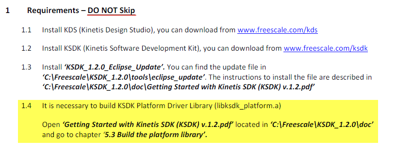

I find on the web "Writing my first KSDK1.2 Application in KDS3.0 - Hello World and Toggle LED with GPIO Interrupt"
https://community.freescale.com/docs/DOC-103288

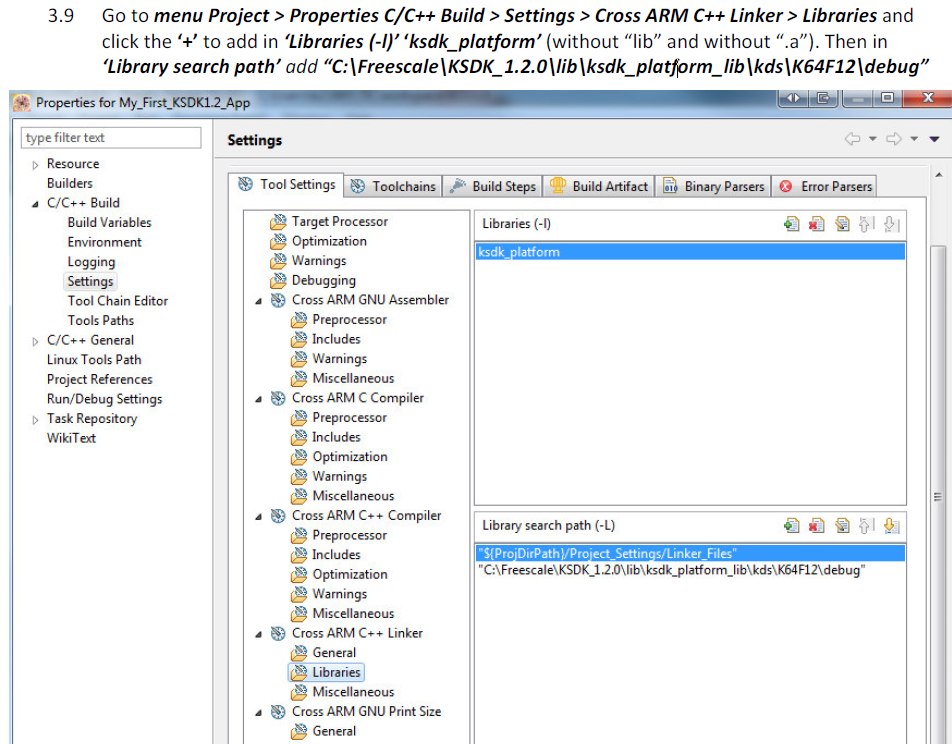

I tryed but page 13 they ask to add :

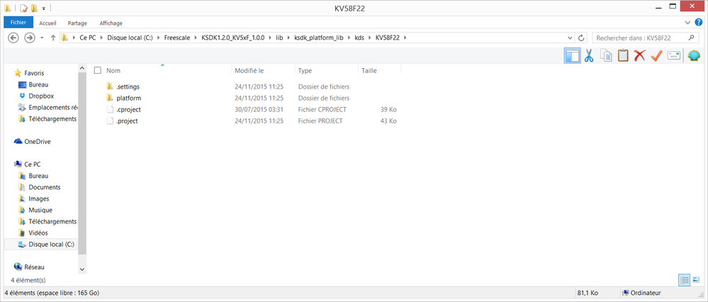

but in my KSDK1.2.0_KV5xF_1.0.0  there are no folder debug?!
So when I compile it can't find ksdk_platform...
Another question, I need I2C and PWM how can I add library for that. One personn (Alice on the forum) told me to use the the SDK-PE component   What does it mean? I shouldn't use my KSDK1.2.0_KV5xF_1.0.0?

Hello alexismaslyczyk:
This is at the beginning of the guide document:
Then yes, the library must be built first so the linker can find it.
Actually there is now a Project Generator that simplifies the process, without having to set paths as in the document. See the details in this link:
New Kinetis SDK Project Generator is available!

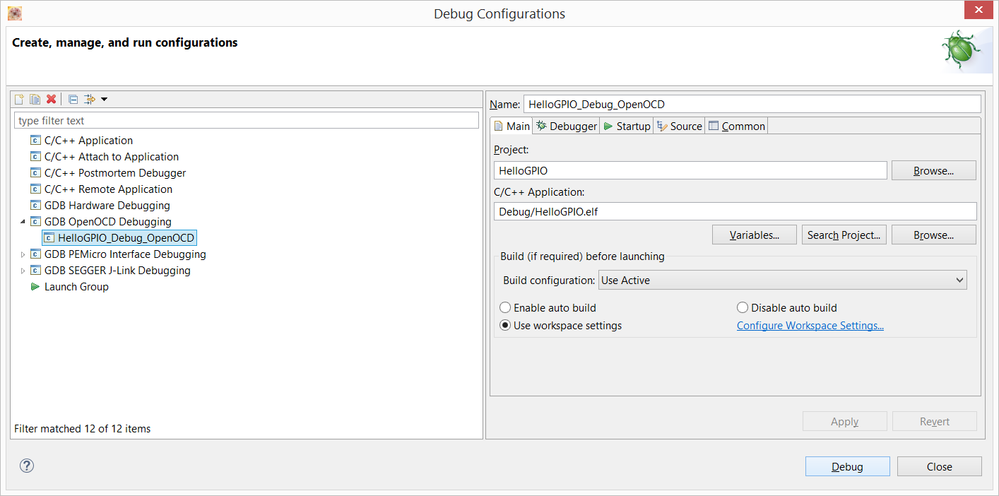

alexismaslyczyk

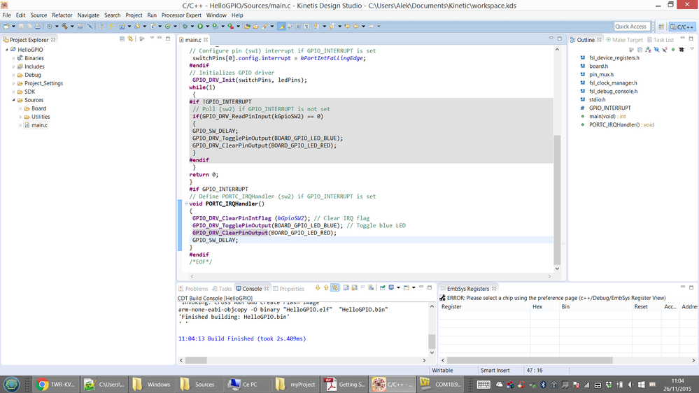

Thank you very much Jorge,

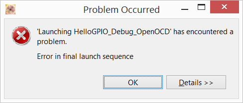

Now i'am able to build my code:
but when I try to debug it:
and finally :
I tryed other thing: build .bin and directly send it to my board via USB MBED, and all the LED onthe board are turned ON (indicate something wrong I guess)
Thank you

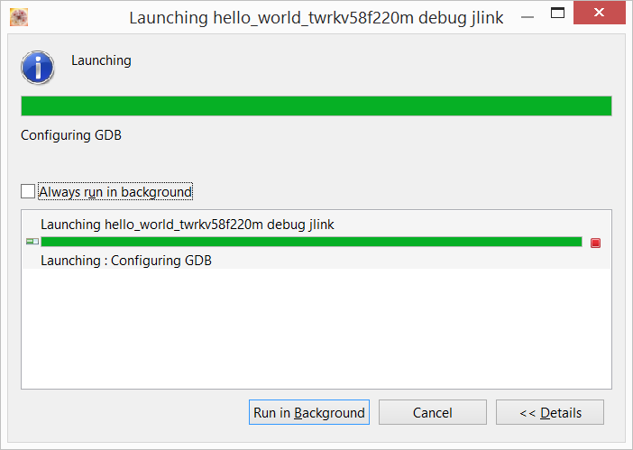

alexismaslyczyk

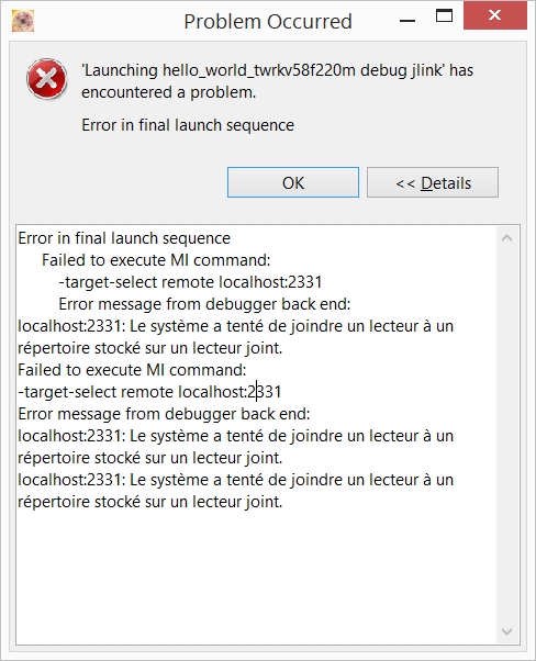

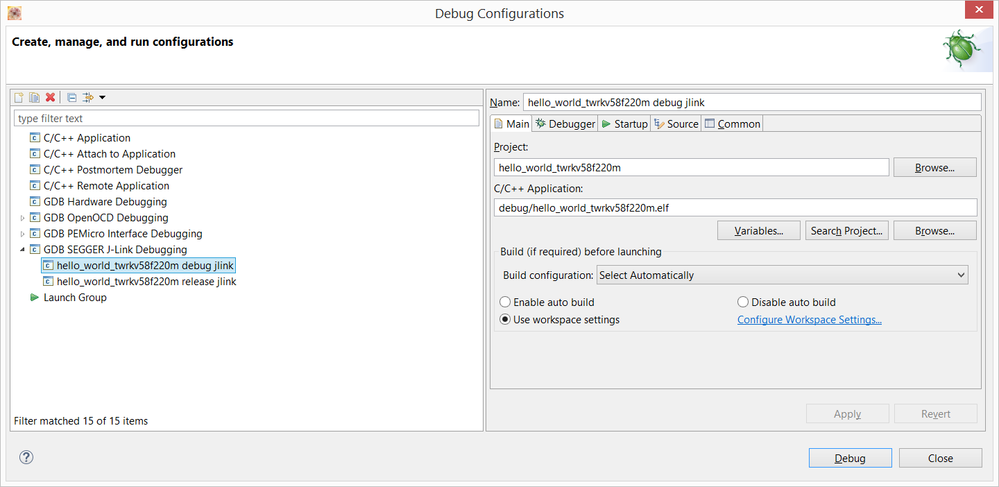

Thanks Carlos, but I got the same problem,
I draged and dropped  JLink_OpenSDA_V2_1_2015-04-23.bin to the boardn and after I do:
And finnally:
4,240 Views

In reference to the JLink application not working.  Segger has changed some things on their end (and we may have made some changes in our IDE as well) so the version of JLink software that you are using is no longer the correct version to use.  Please try the latest from Segger's website which can be found at this link:
SEGGER - The Embedded Experts for RTOS and Middleware, Debug Probes and Production Programmers - Ope...
I believe this will solve your issue.  Please let me know if it does not.

alexismaslyczyk
Hi christopher,
I understand that the board and the µC are new ...
I downloaded the lastest version of SEGGER and I'm not able to debbug my programm,
I think a starter guide how to use KDS and debug via open SDA should be made :smileywink:
