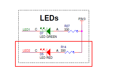

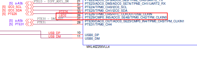

Hello Rohan,
Please check the pin for LED, are sure is PTD5 ?
I think it isn't . Does you use FRDM-KL46 board, if yes , the pin is PTE29 .( Please pay attention to D5 on SCH is not the port PTD 5 )
So you can configuration as this :
