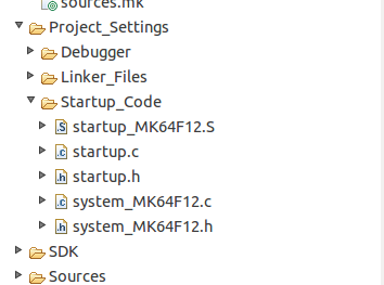

michaelkoller
Hello Alice,
yeah, I have the startup file in the startup code folder of my project.
I created my project with the New->Project->1.x option.
I have installed the KSDK 1.3
Here are some screenshots:
I have everythin included that the UART non blocking example has included. What could be the problem?
Thanks for your help,
Michael
PS: I have the default ISR problem in all projects that use UART at the moment.
PPS: I have included the OSA includes, but not called OSA_Init() in my main. I fixed that, but there is still the default ISR. Here are screenshots from the debugger:
From reading Debugging and diagnosing hard faults on ARM Cortex-M CPUs I have learned, that the default ISR is called, if a handler is missing. How can I determine which handler that is?

Hello Michael,
Do you have the file of "startup_MK64F12.S" ?
What about your project ? Does it create base on KSDK 1.3 ? Or porting one project without KSDK to this project ?
If you just change the debugger mode , we needn't change anything code.
Hope it helps
Alice
