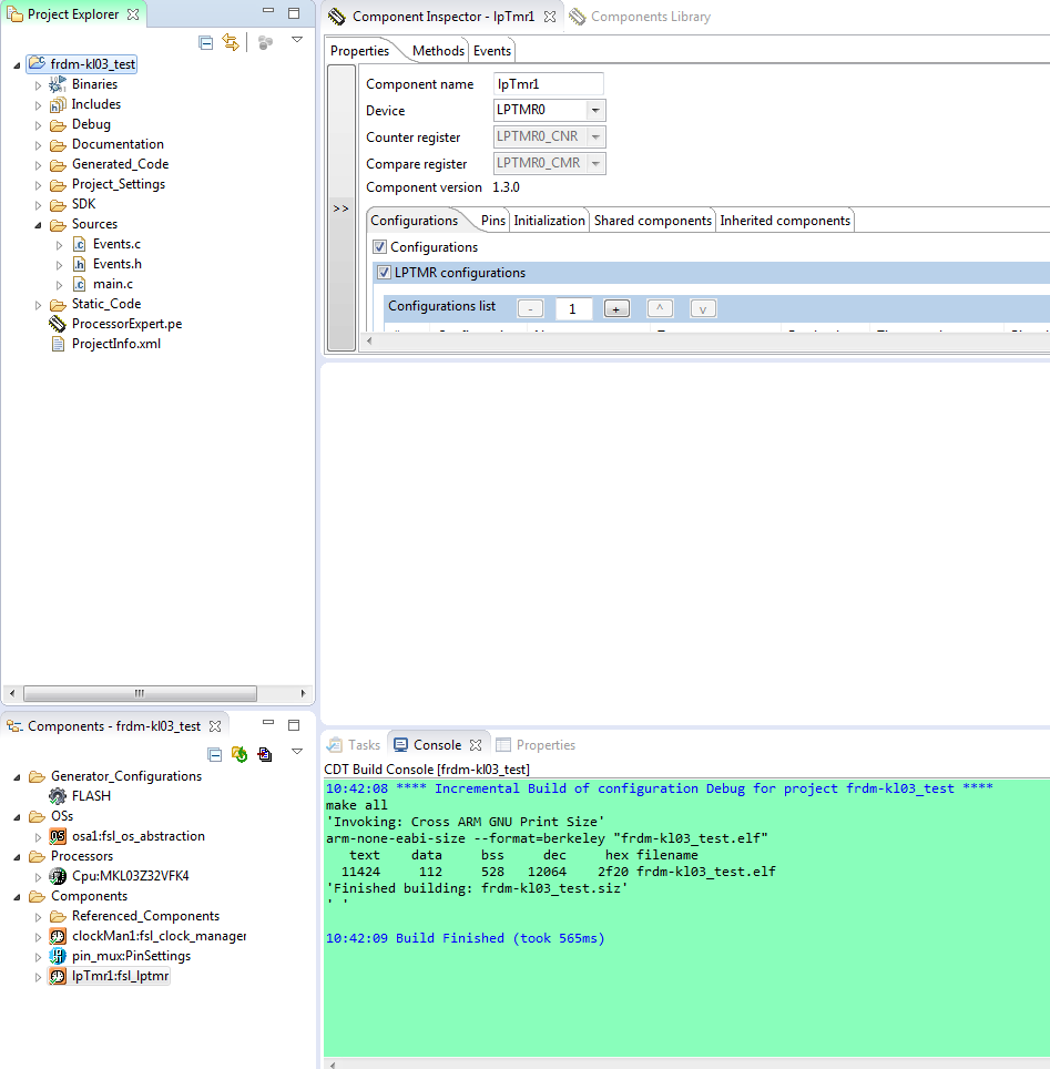

Hello Gnichi,
Do you mean the PE+SDK project,  i create a simple project on KDS3.0 . add the component of "fsl_lptmr",
and click the generate code , build , it have no error , please see the attachment.

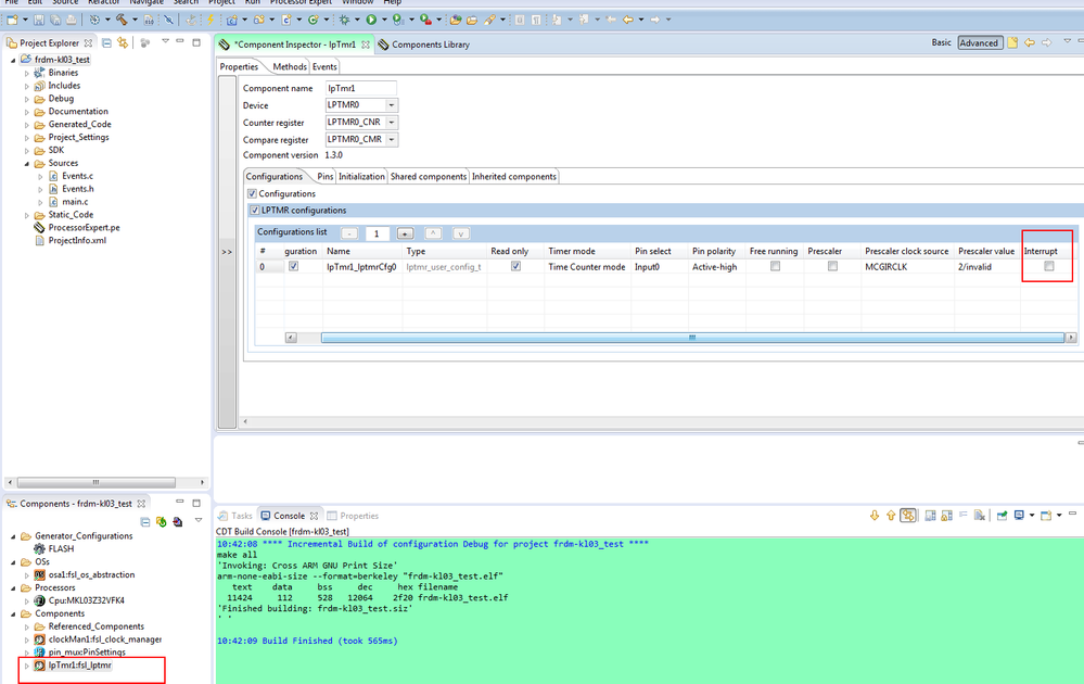

And i don't what's meaning about remove the interrupt interrupt manager component , please take a screenshot tell me , and if you do not want the interrupt , you  can disable it ,for example the interrupt of the lptmr :

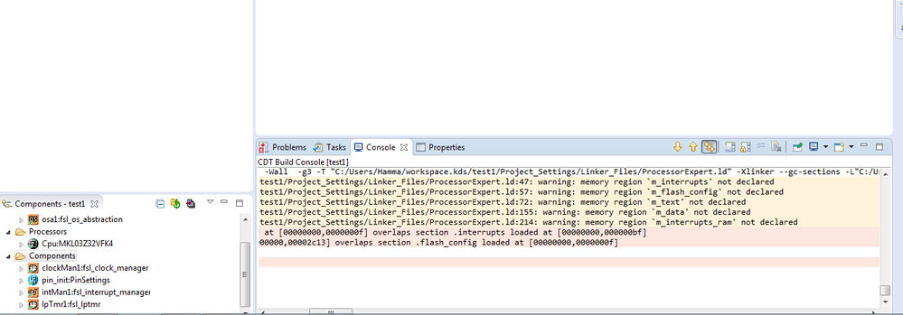

gnichimohamed
As you can see, by default there is a fsl_interrupt_manager component in my project, Also when i replace the content of ProcessorExpert.ld with MKL03Z32xxx4_flash.ld the compilation runs ok.
