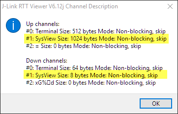

b) make sure you are using the same J-Link version both in KDS and the one used by Segger (mismatch of DLLs can have strange side effects). If you install the Segger software, it does ask you to update the version in KDS (use KDS v3.2.0)
c) Check if the RTT is properly initialized. You can do with the SEGGER RTT Viewer channel infos menu:
Here you have to see the SysView channels:
I have an example project for the FRDM-K64F on GitHub (mcuoneclipse/Examples/KDS/FRDM-K64F120M/FRDM-K64F_Demo at master · ErichStyger/mcuoneclipse · GitHub ) which uses the Segger RTT with SystemView. I have attached the project to this reply as well, so you can try that project.
