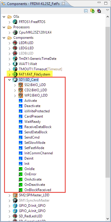

I have been looking for an example code to interface to an SD card through SPI using a MK20 Kinetis microcontroller without using any file system (I do not need to use the card on a computer later, only as storage, so it would be beneficial to skip all the FatFs content).
Could you please point me to the correct example to follow in this case?

BlackNight
You can simply remove the FatFS component from a Processor Expert project, then you have access to the card without a file system:
There is a project for the K20DX128 available on GitHub and described by articles:
Data Logger with tinyK20 Board | MCU on Eclipse
mcuoneclipse/Examples/KDS/tinyK20/tinyK20_DataLogger at master · ErichStyger/mcuoneclipse · GitHub
See as well this tutorial:
FatFS with Adafruit MicroSD Breakout Board and NXP FRDM-KL25Z | MCU on Eclipse
mcuoneclipse/Examples/KDS/FRDM-KL25Z/FRDM-KL25Z_FatFs at master · ErichStyger/mcuoneclipse · GitHub
I hope this helps,
Erich

Thanks a lot for your support and help. I was able to communicate to the SD card without using the file system and read the written data back for verification.
I did run in to a couple of problems, but all of them were documented in your forums based on previous questions of users, you have great examples and great answers to solve issues that come up!
