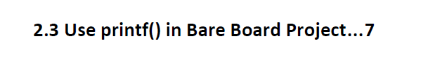

I recommend you refer to this doc:  How to use printf() to print string to Console and UART in KDS2.0
the part of “2.3 Use printf() in Bare Board Project ”
There is also a demo about use printf() in baremetal project. this is for KDSv2.0, while the method is the same
