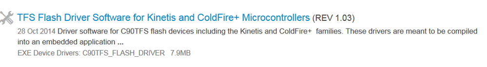

Hello Denis,
- Please first run the flash demo under SDKv2.2 to check whether can work well.
If can't whether can change another debug mode to run.
If it work well, please refer to the code to check your code.
- There is FLASH driver Search Results: c90tfs_flash_driver
it includes flash demo about MKV10Z32xxx4, (under IAR IDE), you can refer to the code to check your code too.
