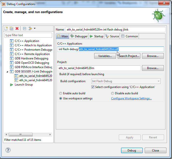

Hi Alice,
I'm using the KDS 1.0.1 (which includes Eclipse Kepler 4.3.1).
When I'm starting the debugging then I'm directly choosing the right debug setting and the setting for itself looks fine.

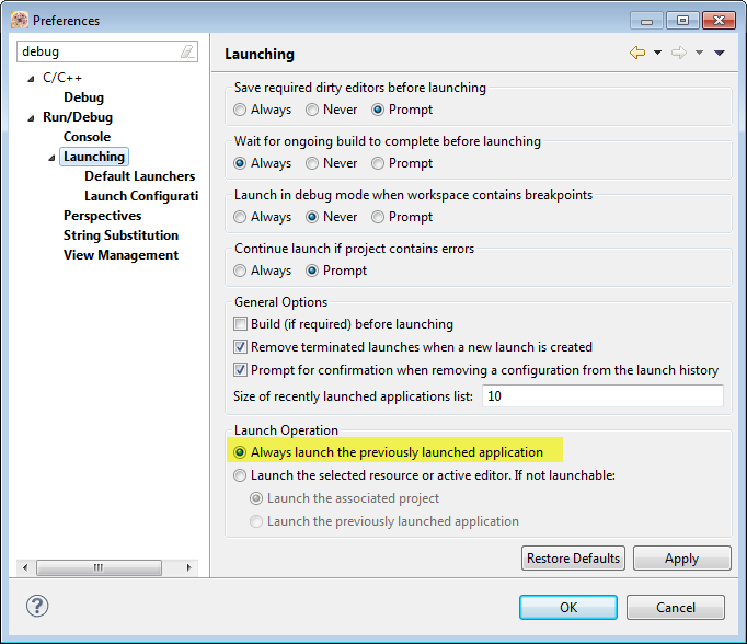

It is an Eclipse Kepler+CDT problem, not a KDS specific one.
There is a setting (shown) below which will ensure that if you press the 'debug' button, it will use the last used project/application:

Unfortunately it didn't work out for me.
Now I replaced the variable in the debug configuration with the real name. Since I'm not quite often change the output file name this is kind of a good solution for me. So, the failure is gone. Perhaps in a year the IDE (eclipse behind) gots rid of this odd behavior.
