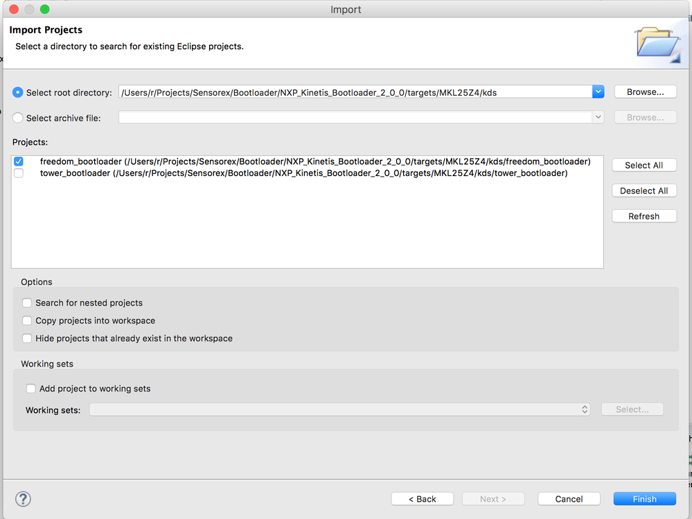

I have copied a freedom_bootloader project into my workspace using these switches (note that "Search for nested projects" and "Copy projects into workspace" are unchecked):
I can compile the resulting project without error.

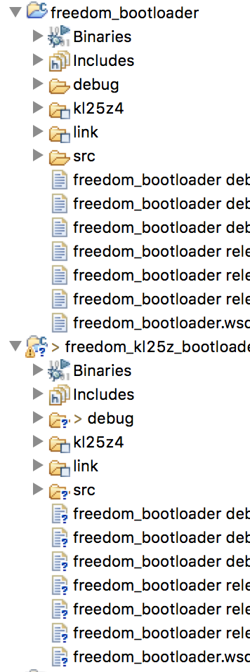

P.S.: One additional bit of info: In my Project Explorer, I note that there a a number of question marks next to the file icons in the copied project -- these don't appear in the original project.  I'm sure they're trying to tell me something:

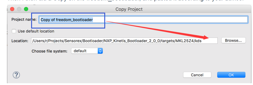

Hello Robert,
I was thinking about you might use the default location when pasting.
When copy&paste project, please don't use the default location, choose the
path where the original project located , on my side , it should be :
after click "Ok" , in the original folder, we can see the project :
Then build the project, there is no error :
Hope it helps

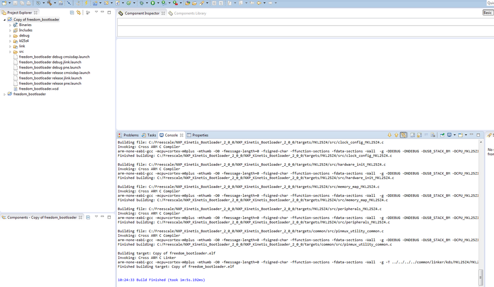

I followed Ma Hui's instruction in Bootloader in half-duplex (RS485) environment  to import the original (un-modified) freedom_bootloader project.  It builds correctly.

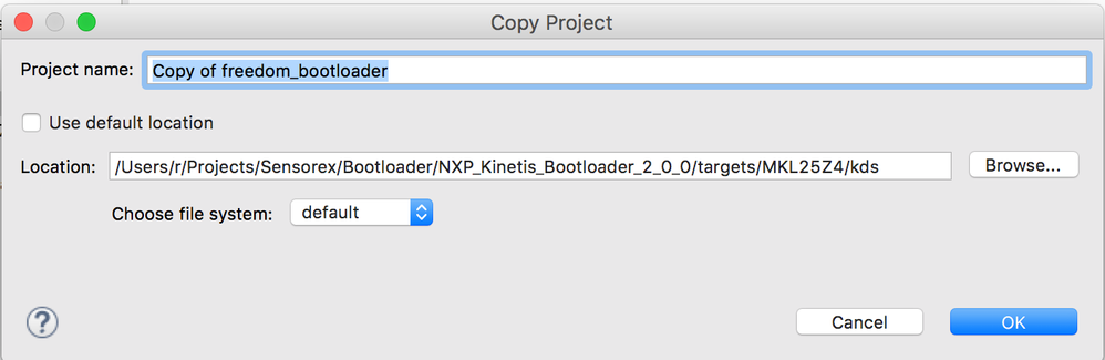

Then I then did a Copy on the freedom_bootloader, and pasted it according to your advice:
But when I try to build the newly copied project, I get this error:

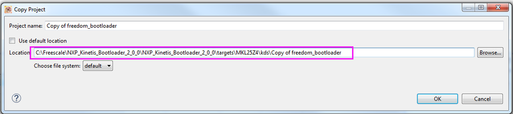

Hi Robert,
In the location path, please also add your project name:
On my last reply :
Hope it helps
TIC
