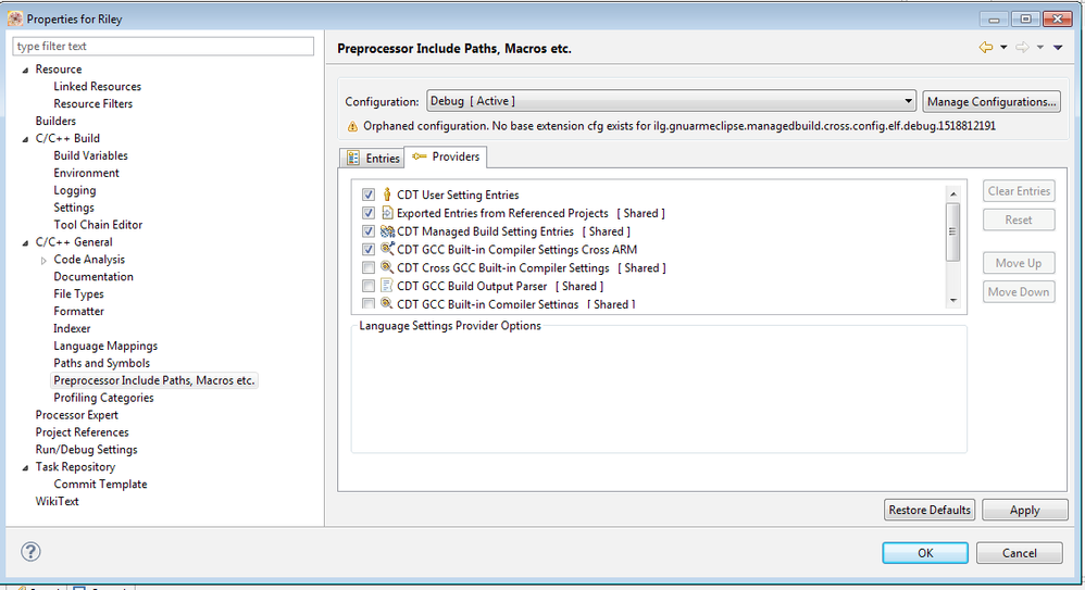

dporada
Can you decode this message?  This could be the problem.
8,831 Views
BlackNight
Yes, that sounds like the wrong or no tool chain. Have you created this project with KDS?

BlackNight
can you share your project,
or at least the
Properties > C/C++ > Settings

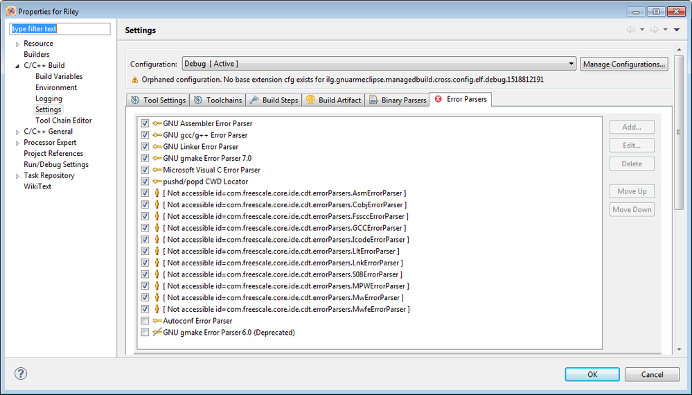

BlackNight
I had a look at this project.
I read that you say above that you have created this project with KDS. But entries in it let me believe that this is a CodeWarrior for MCU project (originally, maybe?).
Or have you opened/modified it with CodeWarrior, or converted it otherwise.
What I see is that the toolchain configuration in it is brocken. This happens for example if a project is using incompatible or orphaned/old tool chains.
So at this stage this is my best guess what happened.

dporada
Well, I have re-created the problem, and you are correct.  This happens when I open CodeWarrior.  I use the same workspace, so the project opens automatically when CodeWarrior is launched.  Even though I get a warning about updating the settings for processor expert and cancel, the change still happens.  When I re-open KDS, I get the Program "-E" error.
I guess I need to have separate work spaces to get around this problem.
Thanks for your help.
