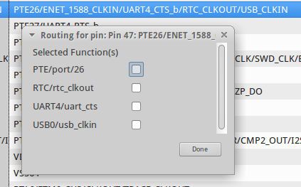

Hallo,
I am working with Kinetis K64 lqfp 144, KDS 3.1 and Processor Expert 3.0.2.

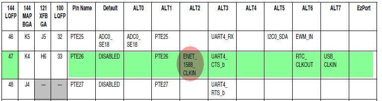

Pin 47 is called PTE26/ENET_1588_CLKIN/UART4_CTS_b/RTC_CLKOUT/USB_CLKIN and can have some functions:
but processor expert doesn't manage ENET_1588_CLKIN function:
How can I set up the pin for ENET_1588_CLKIN function? Only by hand?
best regards
Max

Hello Max,
Yes , it only can configure the PTE26 to ENET_1588_CLKIN function by hand,
through the register of PORTx_PCRn -> MUX .
Hope it helps
