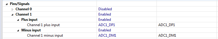

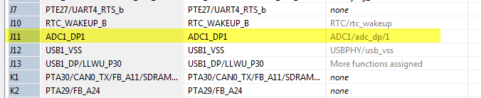

I am setting up a project in Processor Expert (KDS 3.0.1) for a MK26FN2M0VMI18 MCU
It is not possible to select pin ADC1_DP1 as input for ADC1.
Anyone that can help fixing this?

Hi Jesper,
I would recommend you to use Kinetis SDK 1.3 which is the latest release, in this version the  ADC1_DP1 pin is now routed to the ADC1 function:
you should be able to select it as input pin for channel 1:
Hope it helps!
