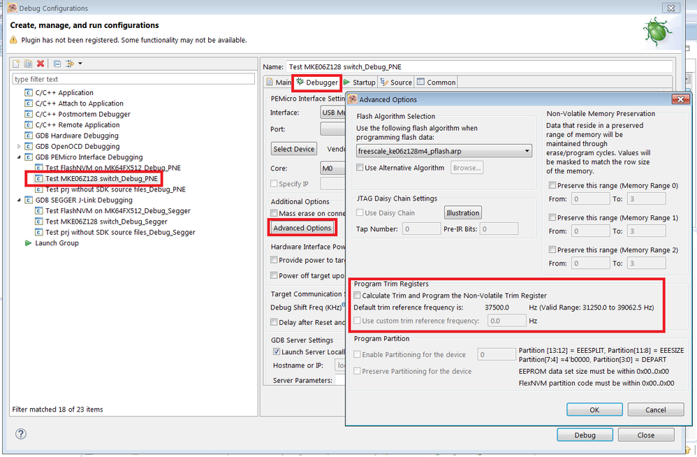

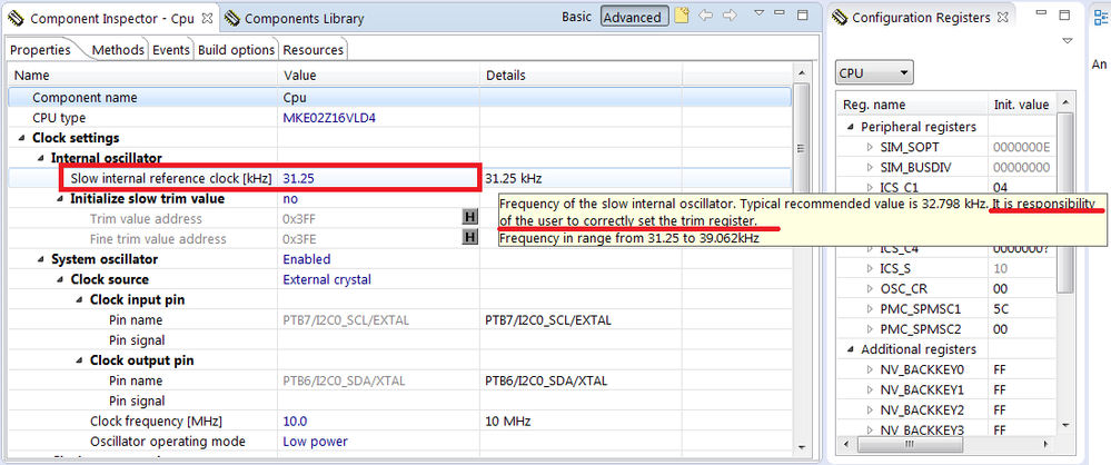

Issue 1:
On P.E. Component Inspector, editing "Cpu", setting "Slow internal reference clock" to 39.0625 and "ICS Mode" to FEI, the clock is not configured properly. The resulting clock should be 40Mhz (output prescaler set as 1), but in fact the clock generated (tested) was 32Mhz. That is because the generated code didn't change ICS_C3[SCTRIM] and ICS_C4[SCFTRIM] to the appropriate value. Actually, there was no apparent change to those registers. Here is the __init_hardware generated code:

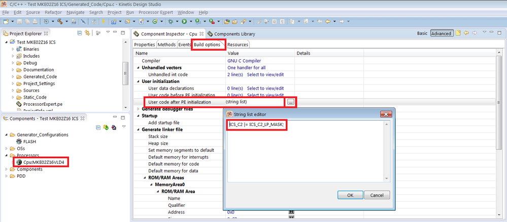

Issue 2:
On P.E. Component Inspector, editing "Cpu", setting "ICS Mode" to FBELP, the actual clock code is not generated on file Cpu.c.
I actually intend to use using FBELP with a 10Mhz oscillator (for better precision), so I really need to know how to fix this! Here is the __init_hardware generated code:

Issue 1:
The Slow internal reference clock property provides support for ICS trim adjustment by other tools (e.g. debugger). The hint of this property states "It is responsibility of the user to correctly set the trim register." This property is only used for calculation of the clock frequencies (clock signals) that are based on this internal oscillator.
There is the Initialize slow trim value property group that allows you to set the exact values of trim registers but these values are not computed (it is your responsibility to set requested values of trim registers), see below:
The default value of the Slow Internal reference clock property contains factory trimmed value of the internal oscillator. But there is not any exact algorithm how to set trim value according to requested value (due to dispersion during manufacturing).
Therefore you can set the value that is in the defined range (defined in datasheet of the MCU and also provided in the hint of this property) and use debugger to adjust precise value of this internal oscillator. For example PEMicro provide the following advanced options (Program Trim Registers):
This feature allows you to precisely set the trim registers.
Issue 2:
I have reproduced the problem. When you select the FBELP ICS mode the Processor Expert does not set the ICS_C1 register in the generated code (it remain in the after reset state - FEI mode). I have reported this issue to the Processor Expert development team (PEXMCU-4163).

Correct that our internal ICR is not as stable/accurate as external clock.  What accuracy on PWM do you require for Ultrasound?
With respect to Question 1.  I too see that changing the "Slow internal reference clock [kHz]" does nothing to the code.  I will report that to the CodeWarrior Processor Expert team.
My workaround (for others that may wish to do this) is to leave it as the default 32.768kHz, run the application and halt, use the Register View to look at the Clock management (ICS) registers, then modify the ICS_C3 to find the correct SCTRIM setting.  This assumes you have enabled the Bus clock output pin under the Internal peripherals Properties of the CPU  component to watch the bus clock with oscope.
Then you need to add code in the CPU.c _init_hardware() function for run-time configuring or ICS_C3 and ICS_C4.

I have received the following workaround from the Processor Expert development team for the issue #2:
1 - Select the FBE mode of the ISC (select the FBE in the ICS mode property).
2 - Navigate to 'Build options' tab in the Components Inspector of the CPU. Find 'User code after PE initialization' property. Enter following code to the string list:
ICS_C2 |= ICS_C2_LP_MASK;
The property allows to generate any user code right at the end of __Init_hardware() function, where the clock are configured. The code sets low power mode, i.e. FBELP ICS mode.

This code allows proper switching from the FBE mode to the FBELP mode according to the following diagram from the reference manual:
Marek Neuzil
