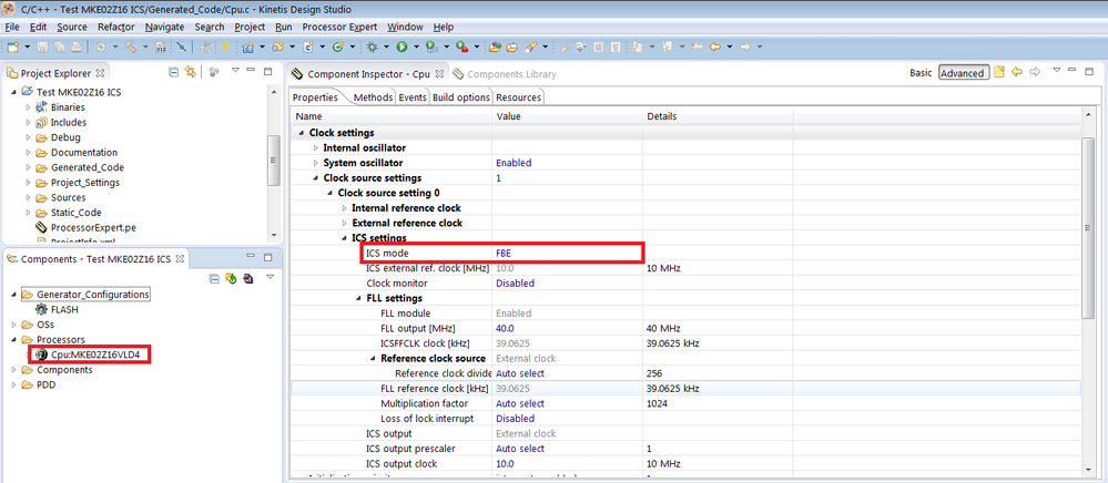

Issue 2:
On P.E. Component Inspector, editing "Cpu", setting "ICS Mode" to FBELP, the actual clock code is not generated on file Cpu.c.
I actually intend to use using FBELP with a 10Mhz oscillator (for better precision), so I really need to know how to fix this! Here is the __init_hardware generated code:

Issue 2:
I have reproduced the problem. When you select the FBELP ICS mode the Processor Expert does not set the ICS_C1 register in the generated code (it remain in the after reset state - FEI mode). I have reported this issue to the Processor Expert development team (PEXMCU-4163).

I have received the following workaround from the Processor Expert development team for the issue #2:
1 - Select the FBE mode of the ISC (select the FBE in the ICS mode property).
2 - Navigate to 'Build options' tab in the Components Inspector of the CPU. Find 'User code after PE initialization' property. Enter following code to the string list:
ICS_C2 |= ICS_C2_LP_MASK;
The property allows to generate any user code right at the end of __Init_hardware() function, where the clock are configured. The code sets low power mode, i.e. FBELP ICS mode.
The initialization code generated (CPU.c program module) by Processor Expert is:
void __init_hardware(void)
  /* System clock initialization */
  /* SIM_BUSDIV: ??=0,??=0,??=0,??=0,??=0,??=0,??=0,??=0,??=0,??=0,??=0,??=0,??=0,??=0,??=0,??=0,??=0,??=0,??=0,??=0,??=0,??=0,??=0,??=0,??=0,??=0,??=0,??=0,??=0,??=0,??=0,BUSDIV=0 */
  SIM_BUSDIV = 0x00U;                  /* Update system prescalers */
  /* Switch to FBE Mode */
  /* ICS_C2: BDIV=0,LP=0 */
  ICS_C2 &= (uint8_t)~(uint8_t)((ICS_C2_BDIV(0x07) | ICS_C2_LP_MASK));
  /* OSC_CR: OSCEN=1,??=0,OSCSTEN=0,OSCOS=1,??=0,RANGE=1,HGO=0,OSCINIT=0 */
  OSC_CR = (OSC_CR_OSCEN_MASK | OSC_CR_OSCOS_MASK | OSC_CR_RANGE_MASK);
  /* ICS_C1: CLKS=2,RDIV=3,IREFS=0,IRCLKEN=1,IREFSTEN=0 */
  ICS_C1 = (ICS_C1_CLKS(0x02) | ICS_C1_RDIV(0x03) | ICS_C1_IRCLKEN_MASK);
  while((ICS_S & ICS_S_IREFST_MASK) != 0x00U) { /* Check that the source of the FLL reference clock is the external reference clock. */
  while((ICS_S & 0x0CU) != 0x08U) {    /* Wait until external reference clock is selected as ICS output */
  /*** End of PE initialization code after reset ***/
  /*** User code after PE initialization and before C initialization ***/
  /*** End of user code after PE initialization and before C initialization ***/
This code allows proper switching from the FBE mode to the FBELP mode according to the following diagram from the reference manual:
