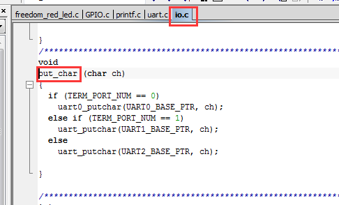

BTW, I observed the printf() function in demo code, however I removed it and used uart to print on my PC instead. How can I use the printf() in the demo code please?

Hello Shaocheng,
Do you meaning the demo under kinetis_kl46_sc ?
If yes,  the demos use the UART to printf . Yon can find the printf function in the file of "printf.c",
then you can step into check using which UART:
