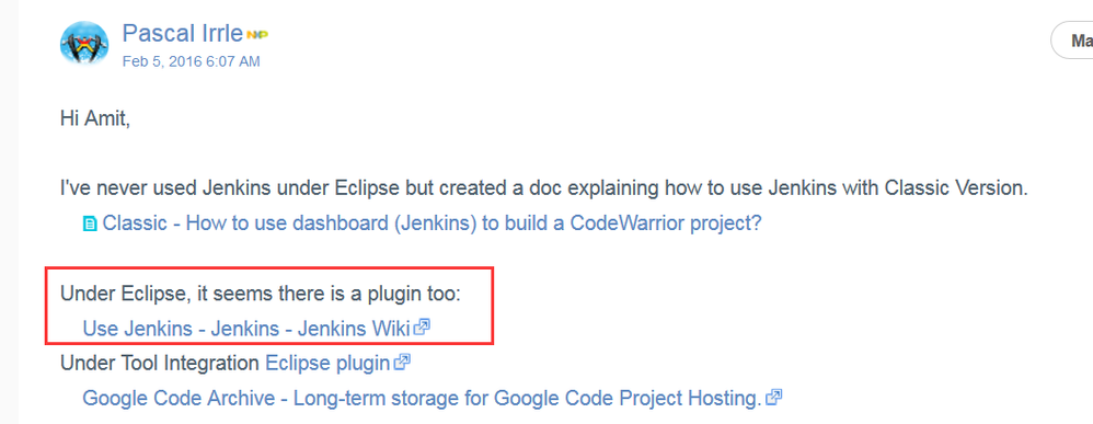

Hello Lukas,
Does the code can build without error on KDS , while there is error when use Jenkins  ?
If yes, I recommend you find and ask this problem on the Jenkins website ,
there is more people know the Jenkins clearly .
My software builds on my computer but not on Jenkins - Jenkins - Jenkins Wiki
Where to find us - Jenkins - Jenkins Wiki
On the NXP community , there is only a tutorial about use Jenkis to build a CW project, it is Classic CW,
the KDS is based on Eclips.
Classic - How to use dashboard (Jenkins) to build a CodeWarrior project?
