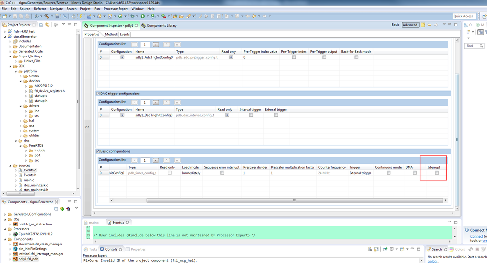

I created what I think is a fairly simple sample project where I want to use Processor Expert to create a DAC output signal Generator.
As a first step I would like to see the PDB peripheral generate a pulse signal to verify that it's working.
I have KDS 3.0.0 installed.
and I created a Kinetis Processor Expert project (please see attachment for all steps that I followed)
I added the PDB Peripheral driver to my project and I believe I configured it to support an IRQ operation also using an external pin output, but when I run my code I do not see any activity.
I do not understand why its not working or what I could have set up wrong.
My sample project can be see on GITHUB: https://github.com/tsbiberdorf/signalGeneratorK22F

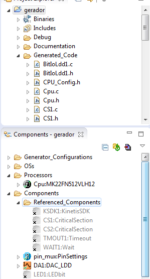

Hello Julio,
- Which version of KDS do you used ? I use KDS v3.2 , open your project
on my side , it like this :
- About the DAC_LDD usage , you can right lick the component, then click the
"help on component" , there is "Typical Usage" , you can refer to :

Hello Terry,
I have checked your project , please enable the interrupt of timer:
Hope it helps

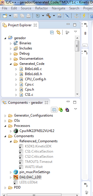

julioruzicki
Hello, I'm tryng make works a kinetis example. The frist one works, but the sendo not. The second uses PDB and interrupts but I noted that the interrupt DA1_OnBufferStart doesn't happens.
Coud you help me?
