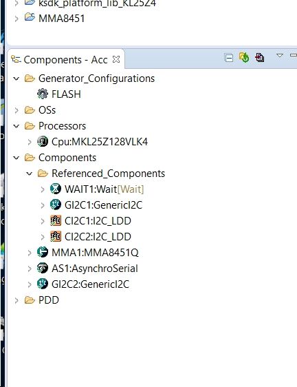

I have an old project wich works fine for me (it uses FRDMKL25, the include MMA8451 and an external I2C component). I would like to start a similar new project, unfortunatly something is going wrong.
In my old project, they were only few components, but now with the new one after creating project, I have a lot of components. Some pictures to explain.
It's my old project with only the things I have added (MMA1,AS1,GI2C2...etc).

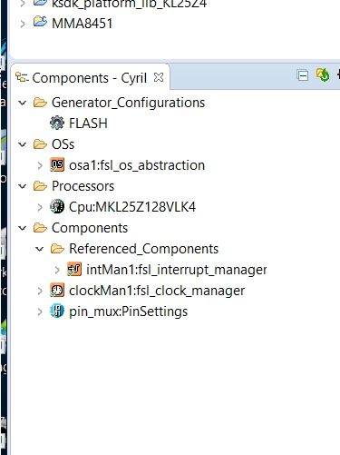

Just after creating the new project, I have strange components (osa1,clockman1,pin_mux..etc).

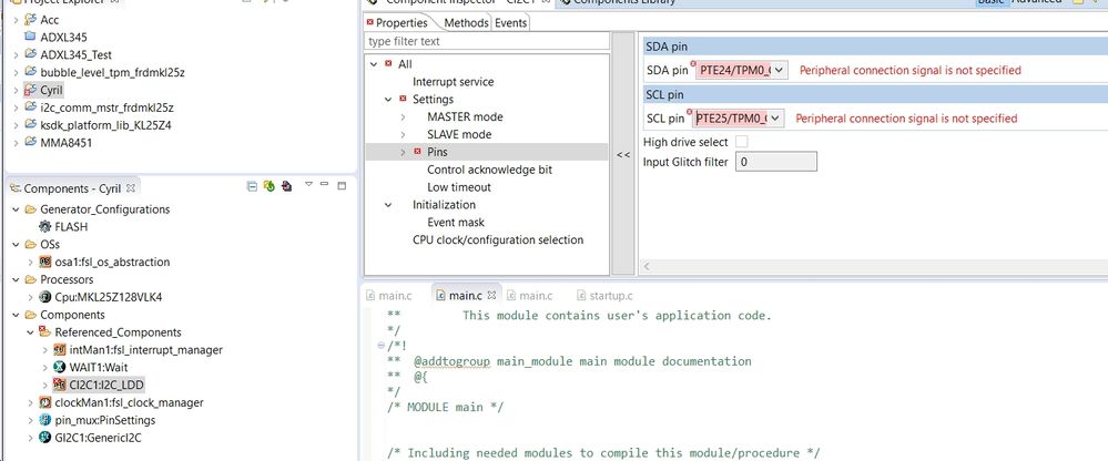

Also when I want to create an I2C connections, I can't select the pins:
My goal is to have a simple project as the old one!! I am not interested by pin_mux,intMan1 ...etc, it was working without that before.

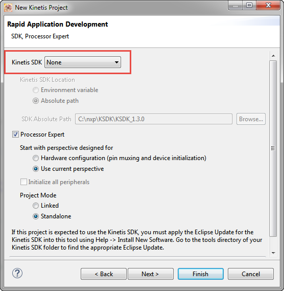

BlackNight
This is because you are using the SDK.
Select 'none' during project creation:
