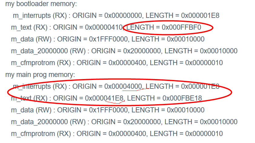

hi!
I want to burn to my MCU, bootloader + main program from KDS.
I successfully burned my bootloader, but when i tried to burn the program, it failed ("J-Link GDB Server failed: Could not connect to target. Please check if target is powered and if ribbon cable is plugged properly.").
i think it might be an error in my MEMORY config (interrupts+text etc..)
my bootloader memory:
    m_interrupts (RX) : ORIGIN = 0x00000000, LENGTH = 0x000001E8
   m_text (RX) : ORIGIN = 0x00000410, LENGTH = 0x000FFBF0
   m_data (RW) : ORIGIN = 0x1FFF0000, LENGTH = 0x00010000
   m_data_20000000 (RW) : ORIGIN = 0x20000000, LENGTH = 0x00010000
   m_cfmprotrom (RX) : ORIGIN = 0x00000400, LENGTH = 0x00000010
my main prog memory:
    m_interrupts (RX) : ORIGIN = 0x00004000, LENGTH = 0x000001E8
   m_text (RX) : ORIGIN = 0x000041E8, LENGTH = 0x000FBE18
thank you for your help.

Hello Matan,
Yes, there are some error in the the memory configuration.
The flash memory rang of bootloader shouldn't beyond the flash start address of your APP memory:
That is to say, the two flash can't overlap.
You can also have a look at this bootloader , check the DOC how to configure memoy:
Kinetis Bootloader to Update Multiple Devices in a Network for Cortex-M4
Hope it helps
