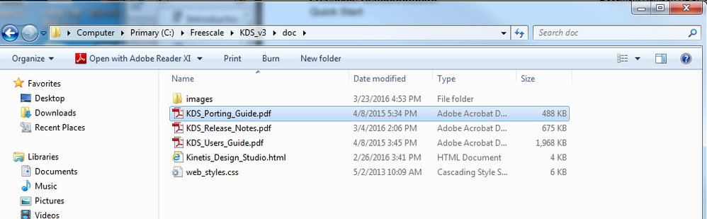

                Will this porting guide be useful for KDS3.2 also???
2,075 Views
ZhangJennie
Hi Vignesh,
yes, It will.
If you have KDS3.2 installed, you will find the same version KDS_Porting_Guide.pdf under KDS3.2 install folder:
