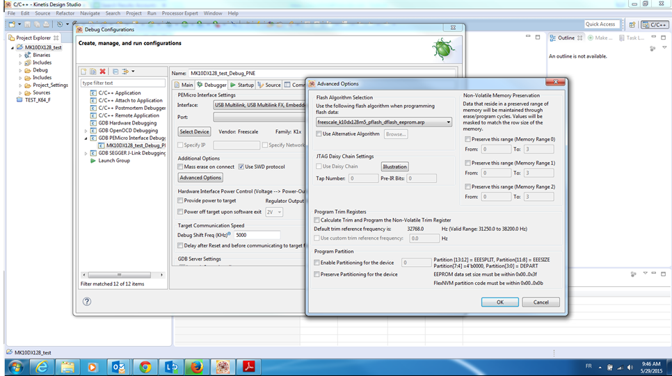

I use CW for MCU 10.6 for my Kinetis K10 and K12 projects but tried to use KDS for first time yesterday.  I could not find where to setup partitioning for FlexNVRAM in KDS.  Anyone know where that is?  I'm using PEM Multilink Universal.

Under KBS V3.0, the option is available.
For details, refer to the P&E doc under the installation folder:
    \pemicro\Kinetis_Design_Studio_Debug_Configuration_User_Guide_v_1_03.pdf

FlexNVM partitioning with SEGGER J-Link
The FlexNVM partitioning can be done with J-Flash or J-Link Commander:
In SEGGER J-Flash there is a project you can use as reference.
1. Open J-Flash
2. Open J-Flash project. It can be found in your JLink folder: \Samples\JFlash\ProjectFiles\Freescale\MK40DX256xxx10_ConfigureDataFlash.jflash
3. Open Options->Project settings->CPU. The procedure how to do a partition is described in the Init steps.
Please refer to the Freescale manual for further information on doing FlexNVM partitioning.
You can do this partitioning also with the J-Link Commander using a Command File.
Example for invocation:
JLink.exe -device MK66FX1M0xxx18 CommanderScript c:\K66FX1M0VMD18.jlink
Example content of a J-Link Command File:
si 1
speed 4000
r
w1 0x40020000, 0x70
w1 0x40020007, 0x03
w1 0x40020006, 0x80
w1 0x40020005, 0x00
w1 0x40020004, 0xFC
w1 0x4002000F, 0x00
w1 0x40020000, 0x80
sleep 5
w1 0x40020007, 0x80
w1 0x4002000B, 0x32
w1 0x4002000A, 0x0D
w1 0x40020000, 0x80
sleep 5
r
If you like to get further information using command files please read the instructions in the J-Link User Guide.

just got P&E feedback.
Currently KDS does not have the advanced programming options to allow partitioning of the EEPROM and DFlash on the FlexNVM.
P&E is currently working on a solution to allow partitioning.
At this time I can not give any release date.
I will keep you informed.
Pascal

trytohelp
Hi Roger,
Do you refer to FlexNVM ?
Below the information provided under MCU V10.6 installation.
Enable Partitioning
Setting the Enable Partitioning checkbox enables you to partition your Kinetis chip. To setup partitioning, you must provide two bytes in hexadecimal format. The first byte represents the EEPROM Data Set Size, which determines the amount of FlexRAM used in each of the available EEPROM subsystems. This byte must be in the range of 0x00 to 0x3F. The second byte represents the FlexNVM Partition Code, which specifies how to split the FlexNVM block between data flash and EEPROM backup memory supporting EEPROM functions. This must be in the range of 0x00 to 0x0E. Refer to the reference manual specific to the device you are working with for more information on how to specify the EEPROM Data Set Size and FlexNVM Partition Code.
Note:This option is only available for Kinetis K-series devices with Flex memory.
Under KDS it's not the case.
On the PEMicro web site I've found:
      P&E Microcomputer Systems
I will check with the P&E.
