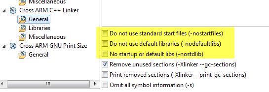

I think this in the linker options is your problem:
-nostartfiles -nodefaultlibs -nostdlib -Xlinker -z -Xlinker muldefs -Xlinker -static
With this, you say that the linker should not use the default libraries and standard libraries: I suggest you try this:
Not sure why you have the additional -Xinker options, are they needed by MQX?

markkurönö
Erich Styger kirjoitti:
I also experienced this after installing KDS3.0 alongside KDS2.0
After trying KDS3.0, all my projects in KDS2.0 workspace got those odd options, and failed to compile.
Also, the checkboxes you highlighted were not checked, but the -nostartfiles etc options were added directly to the text field on the Miscellaneous tab.

dafodil
Hi Erich,
Yes, you are good.
I removed -nostartfiles -nodefaultlibs -nostdlib
and add -specs=rdimon.specs
I got no errors, cool.
