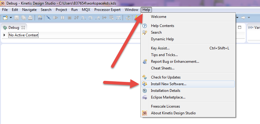

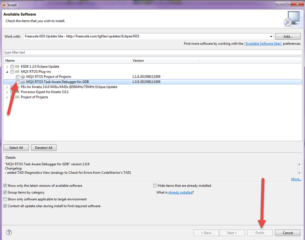

soledad
Hello Alexey,
Could you please add a screenshot of this issue??
Sol
4,323 Views
lukaszjuranek
Hi, I've got similar problem to You, updated KDS to last version. This is my log from TAD plug-in
(15:51:44.119) INFO: [TadState] TAD state changed from DEBUG_RESUMED to READY (Suspended, SIGNAL)
(15:51:47.020) ReadingException: com.freescale.mqx.gdb.tad.model.globalstatus.TadGlobalStatusFactory.getGlobalStatus() at 33.line "readLongVariableSafely(_mqxlite_version_number)"
(15:51:47.052) INFO: [TadGlobalStatusFactory] MQX data valid (version 4.2.0 (0x04020000))
(15:51:47.052) INFO: [TadModel$3] Loading of TAD Global Status took 2933 ms
(15:51:47.052) INFO: [TadGlobalStatusController] TAD global status data is ready!
(15:51:48.206) NullPointerException: com.freescale.mqx.gdb.tad.model.tasklist.TaskFactory.getData() at 71.line "readMemoryBlock32bit()"
(15:51:50.031) NullPointerException: com.freescale.mqx.gdb.tad.model.tasklist.TaskFactory.getData() at 71.line "readMemoryBlock32bit()"
(15:51:51.732) NullPointerException: com.freescale.mqx.gdb.tad.model.tasklist.TaskFactory.getData() at 71.line "readMemoryBlock32bit()"
All windows like MQX TAD Diagnostic or MQX Kernel Data are greyed out, and disabled.
I'm using PEMicro debugger that embedded in TWR-K70F120, do You know what can cause that problems ?
4,323 Views
soledad
Hello Lukasz,
Please check you have installed the MQX RTOS Task Aware Debugger for GDB.
In menu Help, select install new software
Select Freescale KDS Update Site - http://freescale.com/lgfiles/updates/Eclipse/KDS
Install MQX RTOS Task Aware Debugger for GDB.
Sol
4,323 Views
lukaszjuranek
Thanks for the replay. I have got "MQX RTOS Task Aware Debugger for GDB" plug-in installed, without it I didn't have MQX widnow at all. My version of this plugin is 1.0.9.201508111009
