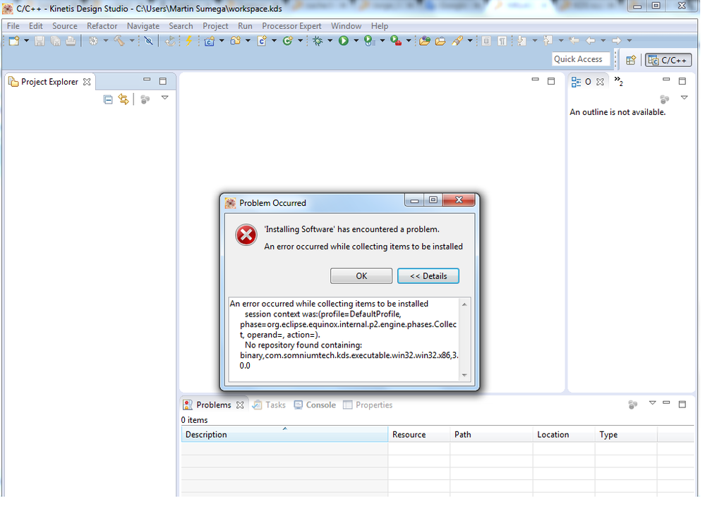

martinsumega
Hi, I have board FRDM KL43z and I want to install support for KL43z into mi KDS according to the instruction in Eclipse_KSDK_Update.pdf from Jorge_Gonzales, but in last step in one fifth of the installation process it makes the error which is in picture.KDS_error.png
4,565件の閲覧回数
Jorge_Gonzalez
Hello Martin:
Can you let us know the Kinetis Design Studio (KDS) version?
Those instructions were for older versions of KDS and KSDK. I recommend you to install the latest versions of both, which now are KDS v3.0.0 and KSDK v1.2.0. Here are the links to the product pages:
Kinetis Design Studio Integrated Development |Freescale
Software Development Kit for Kinetis MCUs|Freescale
Once KSDK v1.2 is installed, follow the instructions in the pdf to install the Eclipse Update in KDS v3.0.0.
Regards!
Jorge Gonzalez
