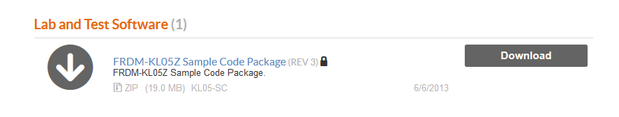

1) About the low power , the attachment "klxx-sc-pex" has a sample created by PE on cw.
  Also there is a bareboard sample  about low power , this is create on IAR, while the application
code  you can refer to , please download it here :
  FRDM-KL05Z|Freedom Development Platform|Kinetis MCU|NXP
( KL05-SC\KL05-SC\klxx-sc-baremetal\build\iar\low_power_demo )
