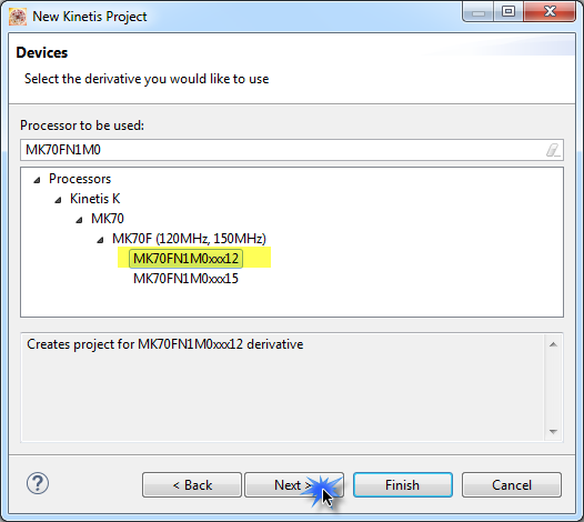

In Kinetis Design Studio version 3.0.0,  when I navigate to File->New->Kinetis Project->(project name)Next->Boards(+)->Kinetis(+)  there is board support for several Tower and Freedom boards, but the TWR-K70F120M is not in the list.
Is there a patch or plugin I can install to add board support for the TWR-K70F120M in Kinetis Design Studio?

Hi Angelo,
The boards you see are the ones supported by Kinetis SDK, the TWR-K70F120M is not supported by KSDK but you can still create projects for the K70 MCUs by choosing the part number:
Hope it helps!

la_dsp
Thanks Carlos.
I was hoping that you could suggest an alternate way of getting the TWR-K70F120M profile in the Kinetis Design Studio since it is not included in the SDK.
Will it work if I import a TWR-K70F120M project that I created in CodeWarrior into Kinetis Design Studio?

Carlos_Mendoza
Hi Angelo,
Yes, you can import your CodeWarrior project to KDS. Here is a document that might be helpful for you:
http://cache.freescale.com/files/microcontrollers/doc/user_guide/KDSPGQS.pdf
