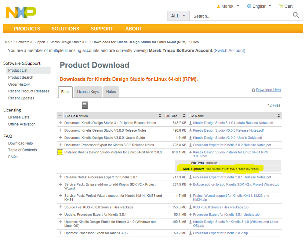

Hi Community.
Someone install KDS IDE on Linux?
I downloaded the Installer Kinetis Design Studio installer for Linux 64-bit DEB 3.0.0 I have Debian 7, but I have troubles with the installation:
# dpkg -i /home/lully/Descargas/Kinetis\ Desing\ Studio\ installer\ for\ Linux\ 64-bit\ DEB\ 3.0.0.deb
(Leyendo la base de datos ... 158354 ficheros o directorios instalados actualmente.)
Preparando para desempaquetar .../Kinetis Desing Studio installer for Linux 64-bit DEB 3.0.0.deb ...
Desempaquetando kinetis-design-studio (3.0.0) ...
dpkg-deb (subproceso): no se puede copiar el miembro del archivo de '/home/lully/Descargas/Kinetis Desing Studio installer for Linux 64-bit DEB 3.0.0.deb' a la tubería de descompresión: fin de fichero o de flujo inesperado
dpkg-deb: error: el subproceso copiado devolvió el código de salida de error 2
dpkg: error al procesar el archivo /home/lully/Descargas/Kinetis Desing Studio installer for Linux 64-bit DEB 3.0.0.deb (--install):
no se pudieron copiar los datos extraídos de 'opt/Freescale/KDS_3.0.0/doc/info/make.info-1' a '/opt/Freescale/KDS_3.0.0/doc/info/make.info-1.dpkg-new': fin de fichero o de flujo inesperado
Se encontraron errores al procesar:
I followed the installation steps.
I should be grateful if you could help me.
Regards.

Hi Lully,
you can find MD5 signature on the NXP web site, see attached picture. It can be used to verify, if the file is downloaded correctly.Capture.PNG

Hi Lully.
I installed on my laptop with Ubuntu 14.04 (64-bit) and I had no problems. In fact I had a problem yes, but not in the installation, but when performing the build, I had to install packages and GCC 32bit and some libraries (libs) for 32bit.
Here are some tips that can help you:
1) Does the file was not corrupted in the download?
2) Try copying the file to /opt, access the directory and there to make the installation procedure.

Hi Gabriel, I dowloaded 3 times the installer, but the error continues, I tried of the second option but nothing yet.
Thak you so much for the answer.

Hi Lully,

Hi Marek and Gabriel, I could install it! :smileyhappy: the download was corrupt. Thank you so much for help me.
