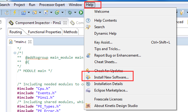

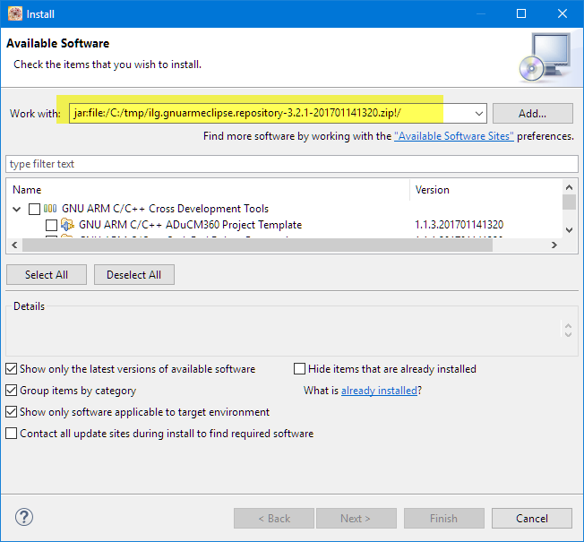

What worked for me is (as a workaround):
1. Download the zip file from GNU ARM Eclipse Plug-ins Releases
2. In KDS/Eclipse, use menu Help > Install New Software and then point to the zip file (or use drag&drop):

Hello Kurt,
The second site you mentioned can open on  KDS , the steps as below:
click Help ->Install New Software...
Input the site into Work with-> click Enter-> wait a while , it will show :
Hope it heps
Alice Yang
