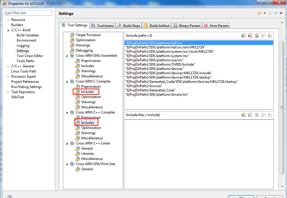

I am working on FRDM-KW41Z development board with KSDK wireless demo apps (i.e. "ble_802.15.4_hrs_mwa"). As per requirements I have modified few files and imported some new files.
Now I want to share this project with my colleague. For that, I am using KSDK provided tool i.e. ProjectCloner.exe.
On my system, I am able to build and run this cloned project, but my colleague is facing some path related issues while building the same cloned project.
Few errors like,
  • fatal error: fsl_os_abstraction.h: No such file or directory DCDC.c /Project03/framework/DCDC/Source line 38 C/C++ Problem
  • recipe for target 'framework/LowPower/Source/PWRLib.o' failed subdir.mk /Project03/debug/framework/LowPower/Source line 31 C/C++ Problem
Please if you can provide some reference document, which can help to resolve our issues.

Hello ,
-About the file paths, you can check here :
Check whether this is absolute path.
- Do you use the same version KDS with your colleague.
- And do you use KSDK v2.0? If it not a secret project, you can share it ,
I check it on my side .

Hi Alice,
Thanks for your response. This information seems helpful to solve this error.
I have corrected invalid locations from following tab in Project properties:
   Resource > Linked Resources > Linked Resources
