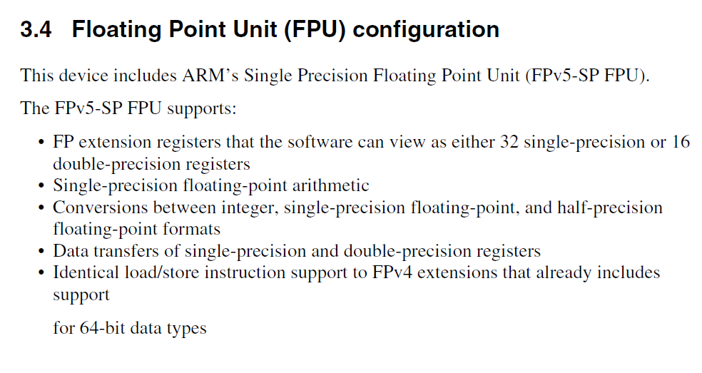

I'm looking for Kinetis MCU that can support double-precision floating point processing.
The KV5x integrated Cortex-M7 core, but I believe that KV5x can only single-precision floating point processing, not supported double-precision processing.
Am I correct?
Please reply as soon as possible.
Takashima
1,413 Views
ZhangJennie
KV5x integerates Cortex-M7 core  which FPU is a single-precision floating point unit (FPU) that is compliant to the IEEE Standard for Floating-Point Arithmetic (IEEE 754).
we can see more information from
http://www.nxp.com/files/32bit/doc/ref_manual/KV5XP144M240RM.pdf
