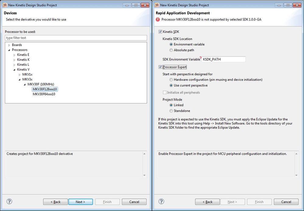

Hi.
I want to create a project for MKV30F128VLH10 in the KDS (version 2.0.0) and use the Processor Expert. But the following error occurs: "MKV30F128xxx10 Processor is not supported by selected SDK 1.0.0-GA".

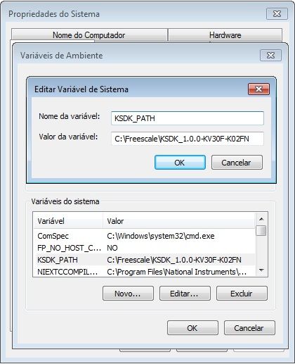

I have installed Freescale_KSDK_1.0.0-KV30F-K02FN on the PC and KDS. The environment variable is correct in Windows.
Could anyone help me?

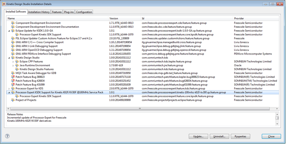

MDB
Hello Jorge.
This error occurred with to install the Eclipse KSDK update (KSDK_1.0.0-KV30F-K02FN).
The figure below shows the KDS installation details (version 2.0.0) on my PC.
Marcos Bloedow
