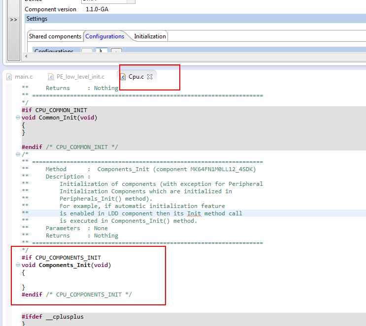

Hi Ole,
There are two ways.
1) select "Auto initialization" , then writhe the initialize function of  EDMA_SPI   to the main function.
2) Do not initialization the device ,  you can checked the " Components_Init()" function like this :
So , you need write initialize code refer to your need to the main function.
In a word,  check the driver function "Description",  then select you need .
Hope it helps
Alice

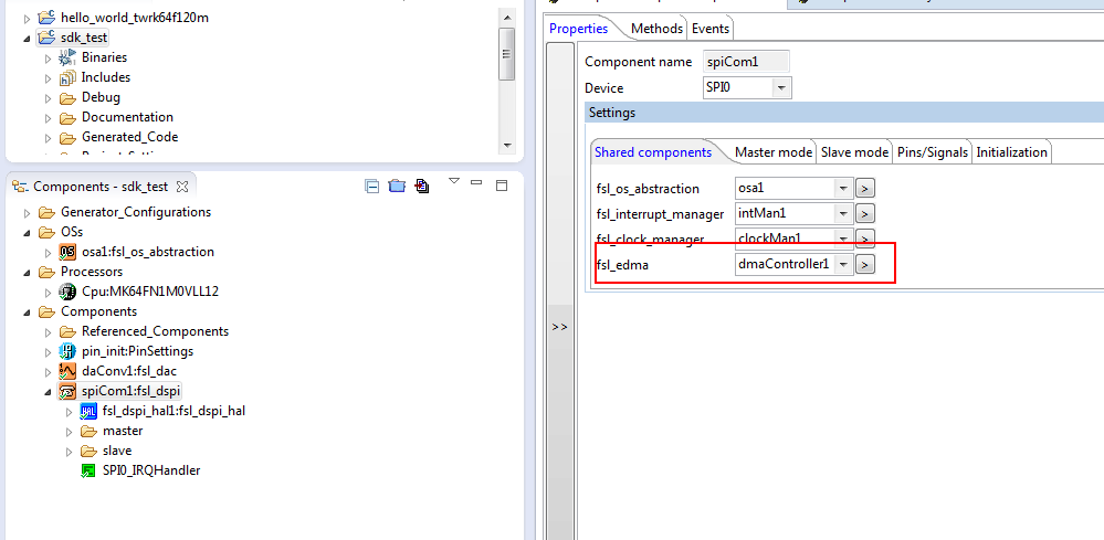

Hi Ole,
You can configuration the spi_dma  on here:
and the related  spi_dma function are  these :
Hope it helps
Alice

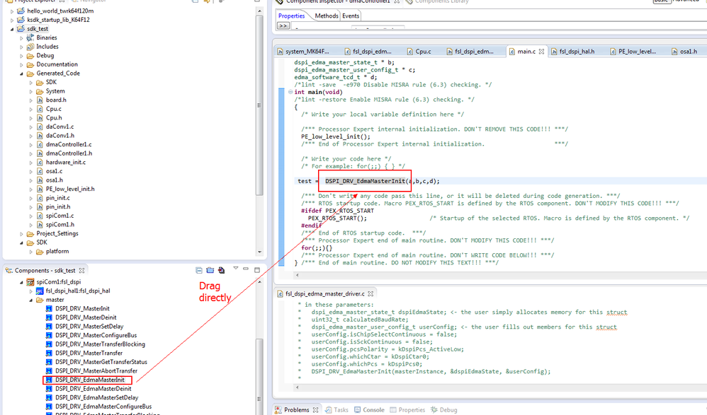

Well maybe I was a bit unclear, the PEx setup is OK but
When using IRQ:
    DSPI_DRV_MasterInit() should be used
When using DMA:
    DSPI_DRV_Edma_MasterInit() should be used
When I open the generated source file Cpu.c it calls the DSPI_DRV_MasterInit(),
so my question is how should I make Cpu.c to call DSPI_DRV_Edma_MasterInit()?
2,300 Views
Hello Ole,
In generate code , the function "DSPI_DRV_EdmaMasterInit"  can not auto show on  cpu.c file.
You can directly drag it to the place you want , like this :
Hope it helps
Alice
