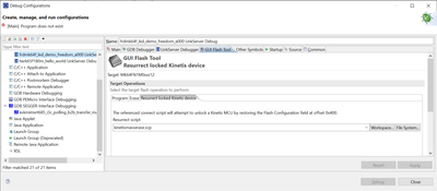

I got a debugger card: MCU-LINK, and installed the latest firmware for it.
But our target board has KL17 MCU, no USB interface. We need hardware team to help wiring out the SWD pins for me, which is in progress.
As this is first time using a debugger card, I wondering if it still works if my target board's MCU is HALT or DEAD.

To unlock kinetis by MCU-Link, you can use MCUXpresso IDE.
Jing

Thanks Jing for the suggestion!
Yes, A debugger should be able to erase or fix the BCA and bring it back to ROM boot.
I'll looking for a debugger and give it a try.
