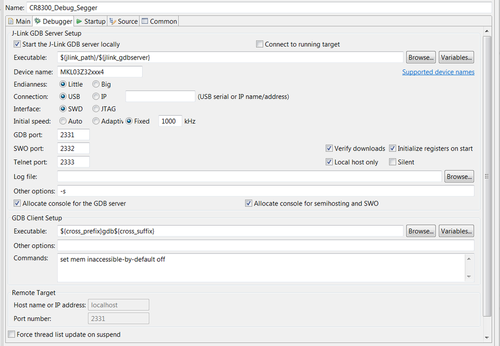

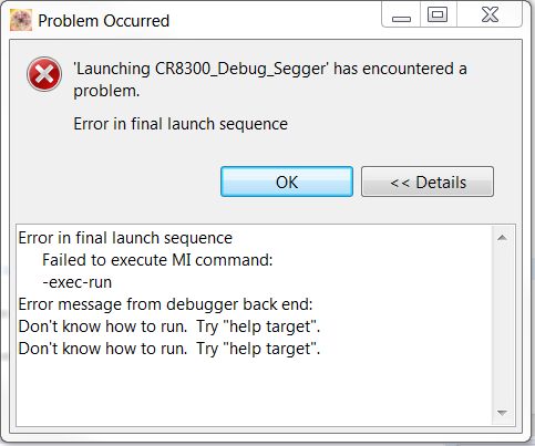

I am struggling to get the KL03Z4 working with OpenSDA Segger. When I go to load the application onto the device, I get the following error.

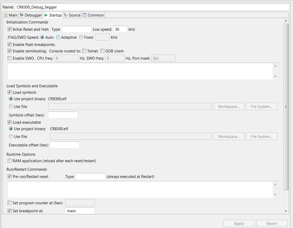

I have the following debug configuration.
3 返答(返信)
1,557件の閲覧回数
alexklimaj
Erich,
I can start JLinkGDBServerCL.exe manually.
I can succesfully use jlink debugging with the provided examples in the SDK. And I have matched the debugging profile settings exactly for my project, but I get that error.
arm-none-eabi-gdb is not already running when I go to debug.
With PNE, I am able to load programs on just fine, but the serial output is very spotty and hard to get to connect. I would much rather use Segger as the serial output is more reliable.

BlackNight
your settings are looking ok. One possible reasons is that it cannot start the Segger J-Link command line executable, which is <KDS installation path>\segger\JLinkGDBServerCL.exe. Can you check that this executable is present and if you can start it manually?
Another reason could be that there is already the arm-none-eabi-gdb excecutable running somehow. Can you check in your task mananager and if yes, kill it?
Other possible tips are listed here: Debugging Failure: Check List and Hints | MCU on Eclipse
