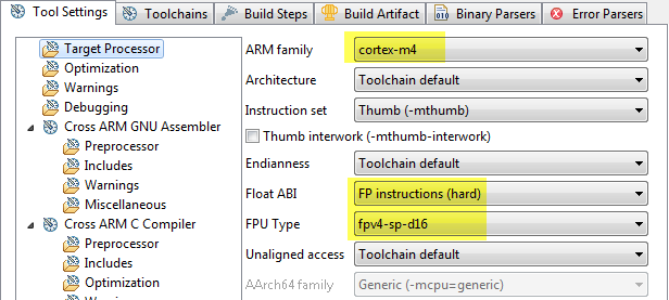

Hello
I try to use the new KDS v3.0.0.
Before, in KDS v2.0.0, for my project, I configured Hardware floating point.
Then, to linked, I added in Project Properties / Settings/ Cross ARM C++ Linker / Miscellaneous, the following library link:
${eclipse_home}/../toolchain/lib/gcc/arm-none-eabi/4.8.0/m4/fp/v4-sp-d16/libgcc.a
${eclipse_home}/../toolchain/arm-none-eabi/lib/m4/fp/v4-sp-d16/libc.a
${eclipse_home}/../toolchain/arm-none-eabi/lib/m4/fp/v4-sp-d16/libsupc++.a
${eclipse_home}/../toolchain/arm-none-eabi/lib/m4/fp/v4-sp-d16/libm.a
which correspond to this absolute path:
C:\Freescale\KDS_2.0.0\toolchain\lib\gcc\arm-none-eabi\4.8.0\m4\fp\v4-sp-d16\libgcc.a
C:\Freescale\KDS_2.0.0\toolchain\arm-none-eabi\lib\m4\fp\v4-sp-d16\libc.a
C:\Freescale\KDS_2.0.0\toolchain\arm-none-eabi\lib\m4\fp\v4-sp-d16\libsupc++.a
C:\Freescale\KDS_2.0.0\toolchain\arm-none-eabi\lib\m4\fp\v4-sp-d16\libm.a
I'm using a K60 (cortex m4)
But now, in the KDS 3.0.0 install repositories these repositories does not exist.
Where can I find the good library to work on Hw Floating point (with FPU) ?
I see for armv6-m, v7-m, and in a root, but how choose one?

Hi Arnaud,
is there a special reason why you specify the libraries 'by hand'?
Because if you use the right family with Float support, it will link the correct libraries:
Additionally, have a look at this document: Kinetis Design Studio: Migrating KDS V2.0.0 Projects to GNU Tools for ARM Embedded (Launchpad, KDS V...

Hello
I have exactly the same configuration than your screenshot.
But if I don't add these link, I have many error on link time.
I don't Remember where I found the way to add these library in configuration, but with this, project Link correctly.
:smileyconfused:

BlackNight
I believe there must be something really wrong with your settings, because the linker shall be able to find the libraries automatically with the correct settings. Can you compare your compiler/linker settings?
I have this (as reference example):
'Invoking: Cross ARM C Compiler'
arm-none-eabi-gcc -mcpu=cortex-m4 -mthumb -mfloat-abi=hard -mfpu=fpv4-sp-d16 -O0 -fmessage-length=0 -fsigned-char -ffunction-sections -fdata-sections  -g3 -D"CPU_MK64FN1M0VMD12" -DFSL_RTOS_FREE_RTOS -I"../Sources" -I"../Project_Settings/Startup_Code" -I"../SDK/platform/CMSIS/Include" -I"../SDK/platform/devices" -I"../SDK/platform/devices/MK64F12/include" -I"../Percepio" -I"../SDK/rtos/FreeRTOS/src" -I"../SDK/rtos/FreeRTOS/include" -I"../SDK/rtos/FreeRTOS/port/gcc" -I"../SDK/platform/drivers/src/uart" -I"../SDK/platform/drivers/src/rtc" -I"../SDK/platform/drivers/inc" -I"../SDK/platform/drivers/src/gpio" -I"../SDK/platform/osa/src" -I"../SDK/platform/osa/inc" -I"../SDK/platform/hal/src/mcg" -I"../SDK/platform/hal/src/rtc" -I"../SDK/platform/hal/src/uart" -I"../SDK/platform/hal/src/gpio" -I"../SDK/platform/hal/src/osc" -I"../SDK/platform/hal/src/sim/MK64F12" -I"../SDK/platform/hal/inc" -I"../SDK/platform/hal/src/port" -I"../SDK/platform/system/inc" -I"../SDK/platform/system/src/interrupt" -I"../SDK/platform/system/src/clock" -I"../SDK/platform/system/src/clock/MK64F12" -I"../SDK/platform/utilities/inc" -I"../SDK/platform/utilities/src" -std=c99 -MMD -MP -MF"Sources/main.d" -MT"Sources/main.o" -c -o "Sources/main.o" "../Sources/main.c"

Hello
I seen a thing in your line because you use SDK:
-L"P:/KDS/FRDM-K64F120M/Lab_KSDK_FreeRTOS/Project_Settings/Linker_Files"
What is these files? Maybe in these file, path is given? So this is why you does not need to add it manually like me in Miscellaneous Linker option??
1,695 Views
BlackNight
The -L option tells the linker where to search for the linker file(s). That's usually a better way than to specify the path together with the linker file name.
