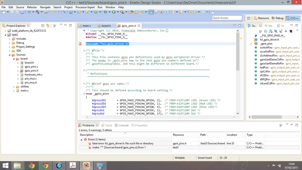

I can not build my first program with KDS. I've got KDS
I've got this message :
DescriptionResourcePathLocationType
fatal error: fsl_gpio_driver.h: No such file or directorygpio_pins.h/7code/frdmk22fline 33C/C++ Problem
and I don't find the file anywhere
Help me please

Hello remi:
I think you missed to add the drivers include folder to the include paths:
"${KSDK_PATH}/platform/drivers/inc"
That is why the compiler cannot find the file "fsl_gpio_driver.h". Please add the path and let me know if you still have problems.

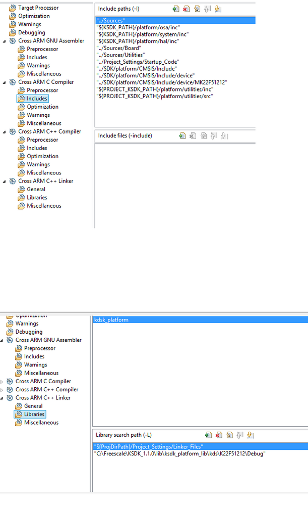

Thank you for reply. I runway the pdf tuto of Carlos Musich but i've got an error at the end of the build project (3.16).
This is my workspace :
And the include settings :
I I have started again several times, I don't no where i'm wrong, .. thank's for your help

Well done ! That works
