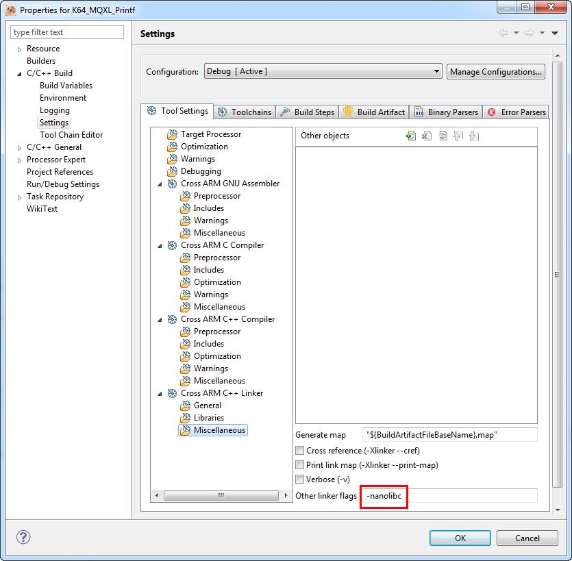

I've run into an issue with KDS when using the nanolibc library and printf.  With this library, the printf only prints the first character.  If I remove the linker option -nanolibc, then printf works as expected.

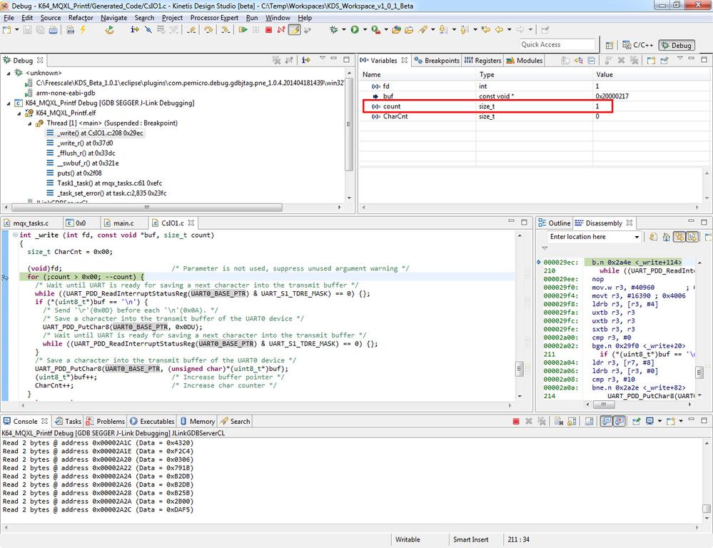

I'm using the attached project for the FRDM-K64F Freedom board.  I've used Processor Expert (PEx) to add MQX Lite and the ConsoleIO component.  The attached project uses the option -nanolibc, and shows the issue.  Debugging the issue, I put a breakpoint in the function _write() generated by the ConsoleIO component in CsIO1.c.  The parameter count for the character count to send out the UART is set to 1 when -nanolibc, no matter what the length of the printf string is.  If I remove the linker option -nanolibc and debug, the character count is passed correctly as expected.
I haven't figured out how to debug the library for why the count parameter is 1, since I haven't found the library source code yet.

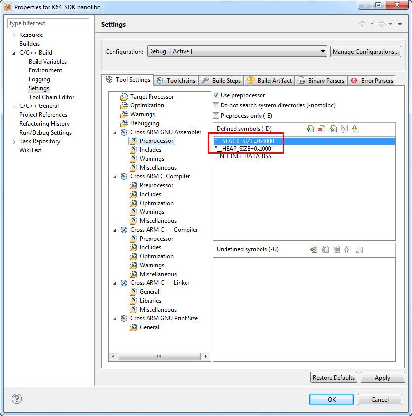

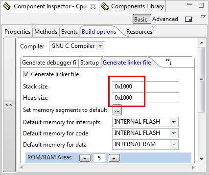

Increasing the heap and replacing _isatty() fixed the issues for me.
Attached are two projects that both run on the FRDM-K64F board using KDS v1.0.1 and the -nanolibc linker option.  One project is built with the Kinetis SDK and no Processor Expert (PEx).  The other project uses PEx and no SDK.
For the SDK project, the stack and heap size are set in the Assembler settings:
For the PEx project, the stack and heap sizes are set in the Build Options properties of the CPU component.

What about HEAP size? I see in another thread that the GNU library in KDS needs at least 400 bytes or more of HEAP space allocated in the linker file.
