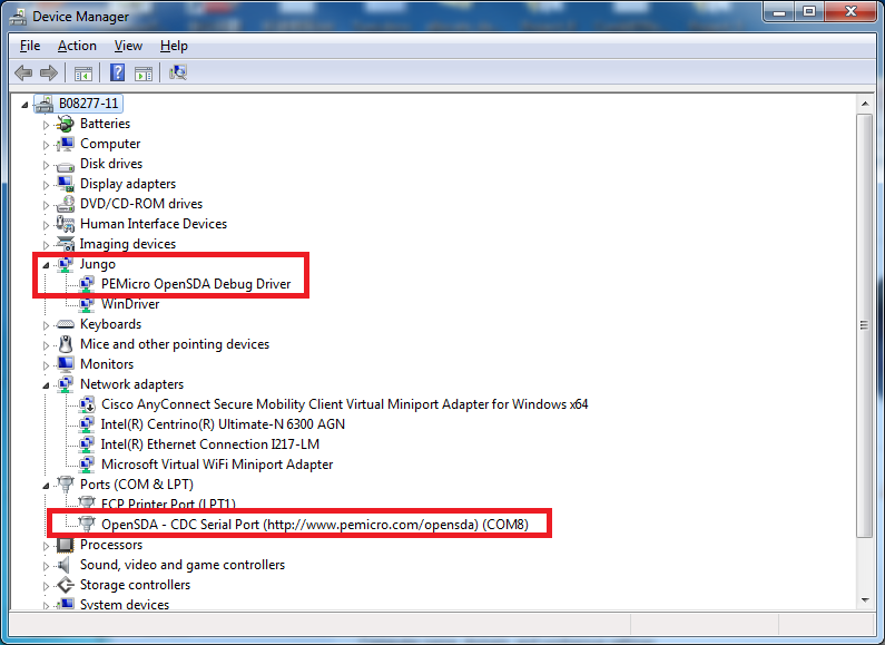

Ken
I don't think that reinstalling KDS (or down-grading) will help. More likely you need to re-install the USB driver since possibly something has gone wrong there.
When you have the debugger correctly installed you should see something like
You can also check your device manager since it will show the debugger
Below is the console output during the download of a project to the board (I am assuming you are using a FRDM-KL46Z).
However I suspect that your problem is not with the debugger but with the chip since the debugger doesn't look to be able to communicate with it.
Have you loaded any code to it before? (eg. with the the debugger's USB-MSD loader - dragging-and-dropping a file on its disk?). It is possible to lock out the debugger with bad code so check the forum for topics on unlocking the chip if that is the case.
Also try loading one of the binary files at µTasker FRDM-KL46Z support using the USB-MSD loading method to see whether the debugger can load using the other method. Maybe it can and then it will clear up the issue with the debugger (?)

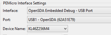

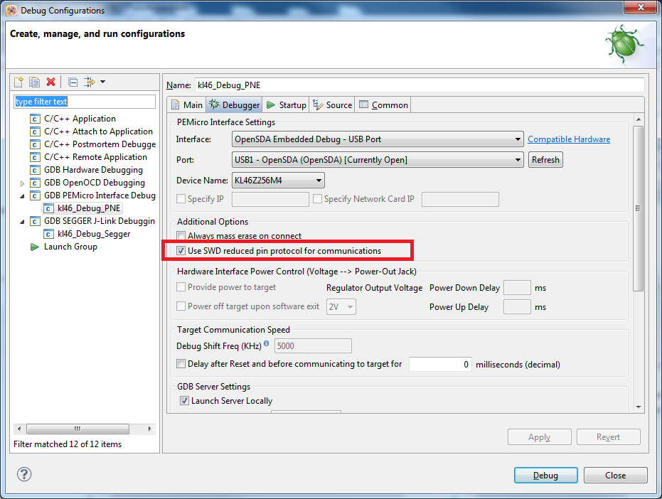

ZhangJennie
Hi Ken,
0. I use attached SDA debug bootloader. It works perfect on my FRDM-KL46Z board.
1. first please make sure debugger is set as below:
2. after install bootloader, reconnect board, device manager shows like below:
hope this can help you.
Zhang Jun

kenholt
Hi Zhang - Thanks for your suggestion.
My setup does match yours, except that I do not have the Jungo entry on the boards that do not have
bootloader 1.11 installed.
Ken H
