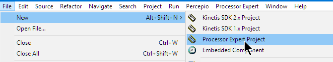

Ben
Senior Contributor I
Hi Erich
Thank you for the support.
I rechecked my activity, I made a mistake in the new project process, and pressed finish instead of NEXT to check the PE checkbox.
It works now, thanks again.
Benny

BlackNight
Hi Benny,
I assume you are talkign about Processor Expert components? If so, you only can add Processor Expert components to the project, if you have created a Processor Expert project. You can see this if there is a .pe file in the project root folder.
And then select Processor Expert:
For SDK v1.3, see Tutorial: Blinky with Kinetis SDK V1.3 and Processor Expert | MCU on Eclipse
Or: FRDM K64F - blinking an LED using #Kinetis Design Sudio and Processor Expert - YouTube
