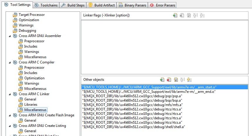

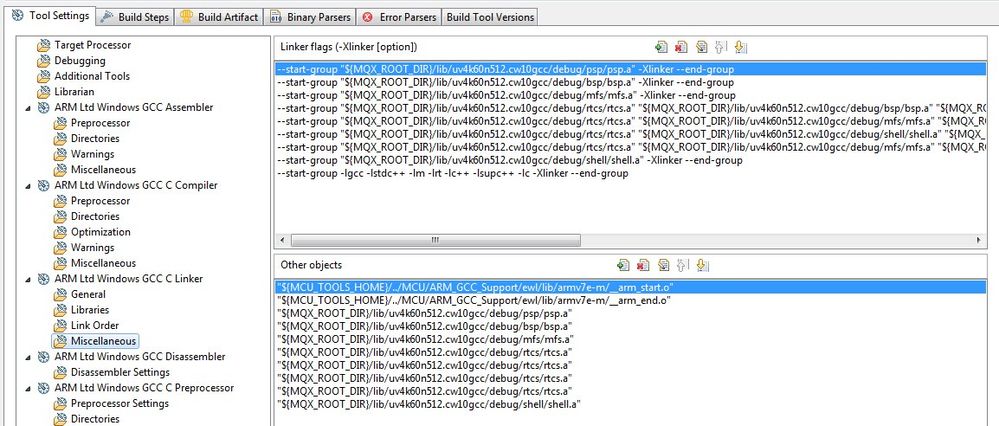

I noticed that there are some contents in "Linker flags" option in CodeWarrior project settings while it's empty in converted KDS project.
In CodeWarrior:
In KDS:
But, even I manually input those options in KDS as the same with which in CodeWarrior, the building error are still the same.
I really confused. What's wrong with the KDS project?

KDS only support GCC compiler. CW10.6 can support both gcc and FSL ARM compiler. from the two screenshot. these two projects use different compiler.
please make sure your CW10.6 project is using gcc compiler too.
MQX4.1 has gcc compiler project. please check use it.
if you want to port Freescale ARM Compilerbased Projects to use ARM GCC. see attached Porting_ARM_GCC.pdf

I forgot to mention that I indeed created the MQX 4.0 project in CW 10.6 by using GCC compiler. From screenshots above you also can find this. Is there any differences between the two GCC compilers in CW and KDS?
8,104 Views
BlackNight
There are differences in the compiler branch/versions. The most obvious differences are in the linker and in the libraries. Aparat of bug fixes between the compiler versions (because of the time difference when they were built), they are pretty much the same. Related to the libraries, the KDS newlib-nano libs have an issue that they use too much heap. But you can replace the build tools with the stock GNU ARM Embedded (lauchpad) tools maintained by ARM if you want or need this (see Switching ARM GNU Tool Chain and Libraries in Kinetis Design Studio).
