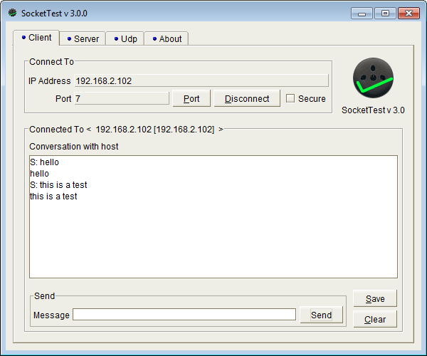

I'm running the following demo from SDK_1.3:
C:\Freescale\KSDK_1.3.0\examples\twrk64f120m\demo_apps\lwip\lwip_tcpecho_demo\tcpecho_rtos\tcpecho_freertos\kds
I can ping the board using the following command:
ping 192.168.2.102
However when I try the echo a packet send by typing:
C:\>echotool 192.168.2.102/p tcp/r 7/d hello
I get :
Host not found
Any ideas?

Hello Koorosh,
I do not know how the echotool works but i would recommend you to use another software (for example Socket test) to test the echo implementation, this documents talks about socket test software (chapter 1) so you can give a look to it: How to Add lwIP to KDS3.0 Project
Once I test this example by using socket test software, I am able to echo messages sent from client:
I hope this can help you!

kooroshhajiani
Hi Issac,
Thanks for the link.
It works.
