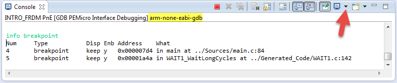

what I have found is a bug in GDB with non-existing-code-breakpoints, see
Failed to Debug with GDB: Breakpoints or Expressions on non-existing Locations | MCU on Eclipse
I have submitted a bug report to the maintainers of the GNU ARM Embedded (launchpad) tools.

BlackNight
In addition, can you check the gdb console and use the 'info breakpoint' command which shows the current breakpoints known to gdb:
