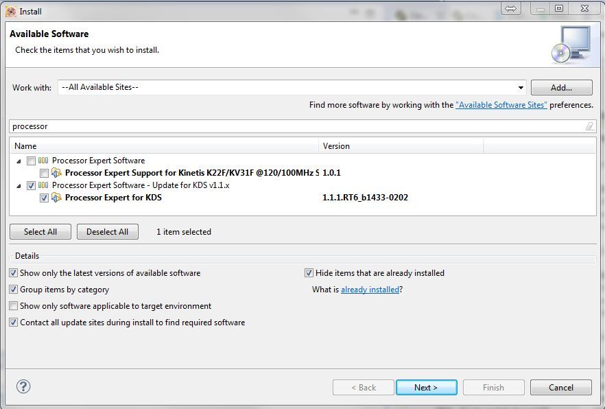

adriancano
It is probably that you need to install an update for Processor Expert environment. In KDS go to Help > Install new Software...
For using KSDK you also need to install the software in KDS. Follow the instruction in the Getting Started with Kinetis SDK (KSDK) file in the KSDK documentation. The section 5.2 Install Eclipse update guides you to make the installation.

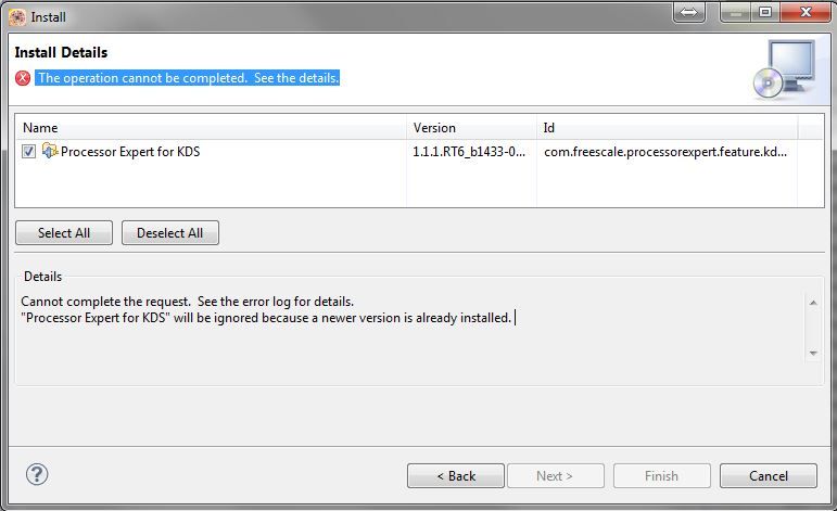

So, when I search for processor expert related updates for eclipse, the items below show up.
I tried installing the one checked on the image, with no success. the error can be seen below.
I didn't try to intall the first package of the list, since I'm using K64.
Any clues?

srmvasconcelos
Hello again,
Although I thought I had the right version already, I followed the guide, installing the correct update. Afterwards, I tried again your first sugestion, getting the same error al over again "Processor Expert for KDS" will be ignored because a newer version is already installed. ".
Still the same errors on building the project.
:smileyinfo:Thanks for the tip, I moved the question to the proper space.
Thank you.
Sergio
EDIT: I deleted the original project, created it again with same parameters, after this new installs, hit build and got no errors!
