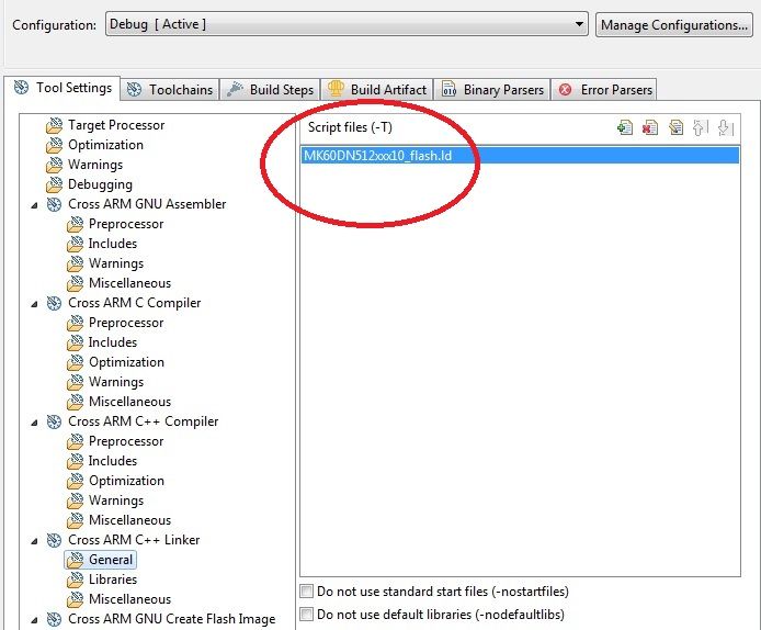

Hi all,
I am using KDS 3.0.0 and KSDK 1.3.0. and trying to debug a C++ project to my custom board PK60N512VLQ100. But when I debug it, it shows "No source available for 0xfffffffe" and disassembly at 0xfffffffe: "Unable to retrieve disassembly data from backend".
Demo-program works just fine.
Read suggestions in the forum and tried a few of them but nothing works.
How do i solve it??
Any help would be greatly appreciated.
Thank you,
YS
9,035 Views
yds
Hi all,
I found the solution to my problem!!!!!
I had missed a setting in the C++ linker option i.e. to tell the linker to use the Flash file and so the problem.
I read this: http://http//mcuoneclipse.com/2014/06/15/tutorial-diy-kinetis-sdk-project-with-eclipse-startup/
Checked the settings in my project and found out what was causing the problem. :smileyhappy:
Anyways, Thanks.

Hello yds,
About the C++ project on KDS , does this can help you ?
Transitioning to C++ with KDS, KSDK, and Processor Expert
Hope it helps
Alice
9,035 Views
yds
Hi Alice,
I checked the link and it does not solve my problem.
The program is hitting some sort of breakpoint. The GDB tells me:
Program received signal SIGTRAP, Trace/Breakpoint trap.
0xfffffffe in ?? ().
What does this mean? and how to solve it?
YS
9,035 Views
Hello yds,
Before you download  the project , please disable all of the breakpoints , and try again.
9,029 Views
yds
Hello Alice,
I have not set any breakpoint in my program. I checked the breakpoints window to make sure of this.
Why do you suppose this is happening??
I have attached GDB logs. Please look into it.
YS
9,029 Views
mstroven
It seems like your processor is getting a reset while your code is running...  Try putting a scope on the reset line to verify.  Do you have the reset pin pulled up externally?  If not, try a 4.7k pullup to Vdd.
