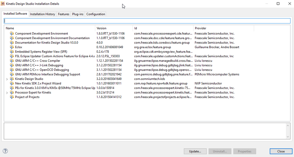

To solve your problem, we need to know your SW version:
- Start the IDE and click on Help | About CodeWarrior(KDS) Development Studio. Send me the version and build id.

I'm using KDS 3.2.0, I've pasted a screenshot of my Version IDs (build numbers?) for KDS prerequisites:pastedImage_2.png

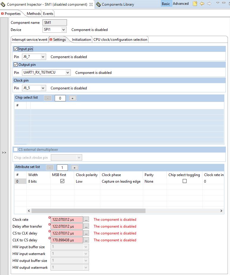

My PE SPI settings are pasted below. This screenshot was taken today when I'd temporarily disabled the SPI module for unrelated reasons, but at the time I was debugging, it was enabled.
