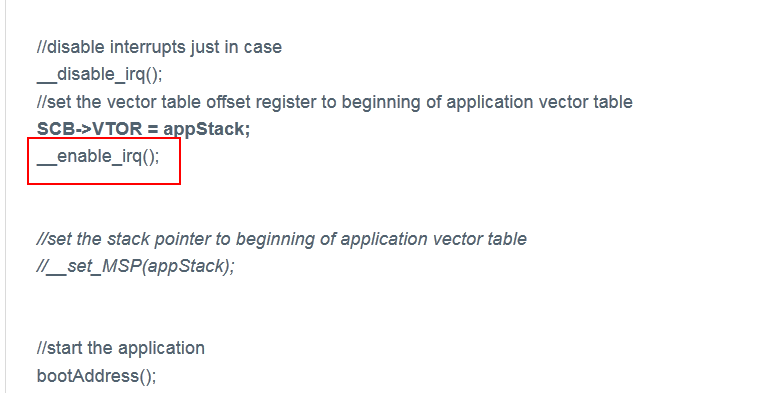

I'm in the process of jumping from bootloader to application code for MKL15Z128VFT4.

Bootloader Code:
//Location of Initial Program Counter for application code
#define APPBOOT_VECTOR 0x7200
void (*bootAddress)(void);
volatile unsigned int * safeBootVector;
volatile unsigned int * appBootVector;
void jumpToAppCode()
  //converting value appBootVector points to, to a function pointer that takes a void arg and returns void
  bootAddress = (void(*)(void))(*appBootVector);
  uint32_t appStack = (uint32_t)(APPBOOT_VECTOR);
  //disable interrupts just in case
  __disable_irq();
  //set the vector table offset register to beginning of application vector table
  SCB->VTOR = appStack;
  __enable_irq();
  //set the stack pointer to beginning of application vector table
  //__set_MSP(appStack);
  //start the application
  bootAddress();

Hello ,
- Why enable the interrupt here :
    could you try enable the interrupt after jump.
-  Do you use KDS IDE ? If yes, there is a code about jump, i think you can refer to :
  // relocate vector table
    SCB_VTOR = RELOCATED_VECTORS;
  JumpToUserApplication(*((unsigned long*)RELOCATED_VECTORS), *((unsigned long*)(RELOCATED_VECTORS+4)));
- There is a bootloader about KL26, i thin you can refer to the jumper code , it is the same as i mentioned above.

Hi Alice,
I tried the code you have suggested and I'm experiencing the exact same behavior. I arrive at the breakpoints I set for the startup_MKL15Z4.s file, I execute the init_data_bss and SystemInit, and then when I step to the __START call, the program jumps to the DefaultISR loop for an exception. If I comment out the SystemInit call, the program will jump from __START to main of my application, but I have to manually step through the code otherwise the exception will be triggered again. I'm not sure what's going on, I'm new to this. Is there an issue restarting the clocks and watchdog in the default code for the SystemInit function? The init_data_bss function appears to be ok transferring the application vector table from flash to RAM and the data rom from flash to RAM.

Update:
So I narrowed it down to here:

If I enable the bare metal OSA Timer (System Tick interrupt) and interrupt in the bootloader code, then I can't successfully make the jump from __start to main in the application portion of the code.
5,188 Views
jonathan_guinta
I figured it out, it was the OSA_Timer interrupt, it needed to be turned off: SysTick->VTOR = 0U. Once this was disabled, then the jump to main in the application code worked.
