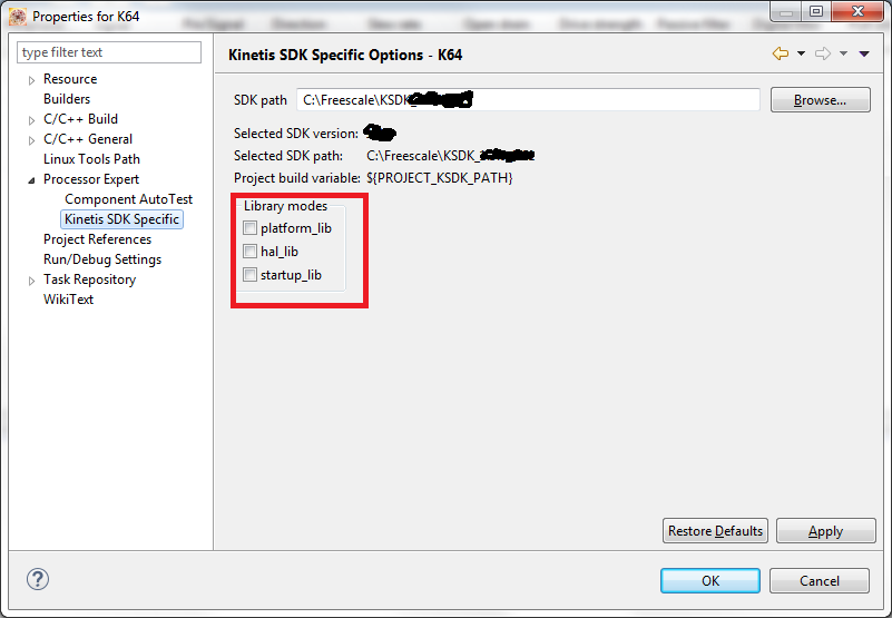

I am trying to build a Processor Expert project using MQX with KSDK.  Using the "Linked" PE project option, the MQX files are not copied into the project space but are linked via KDS and are compiled as a part of the KDS project.  I would like to take this a step further and simply link to pre-compiled MQX libraries (ksdk_platform_mqx, _mqx_stdlib, _mqx - like in the MQX example projects).  I have tried turning off code generation for most of the components, but it seems like there should be an easy way to do what I'm asking since the example projects are built this way.

vfilip
there is option in KSDK specific menu in project options (Right click on project -> Properties -> Processor Expert ). When you check a check-box source files from components marked as driver/hal/startup in ksdk_manifest.xml (in root) are not added to the project. Linking particular lib is user responsibility.

kylehamilton
Vojtech,
I tried these settings previously with no success.  Checking the "startup_lib" box causes system_MK64F12.c to be excluded from the project, but checking "platform_lib" seems to have no effect.  I did a full directory tree compare on a project with this option selected against one without but found no differences.  All of the drivers are still being copied even though "platform_lib" is selected.

vfilip
this options did not work correctly in 1.2. This bug has been fixed in 1.3, you can download it here:
