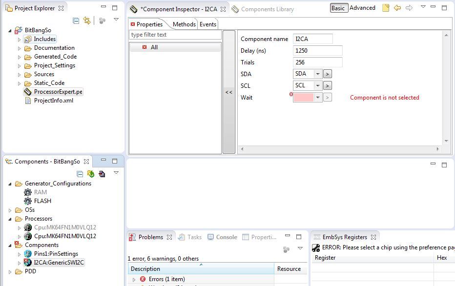

Kewal
Anyways I achieved it through code warrior ..
thanks.

Yeah, actually I tried before posting this question. I got an error with below description
Error during adding referenced component/template "Unsupported/Wait-UNSUPPORTED".
Component is either missing or corrupted.
It was just a project with processor expert and KSDK option as none. Also tried with codewarrior and found same issue.
Do i need to add any other component?
