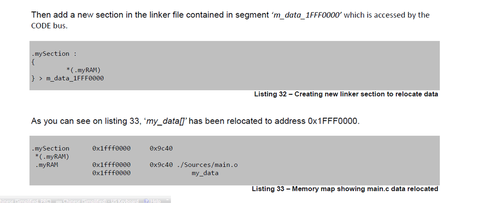

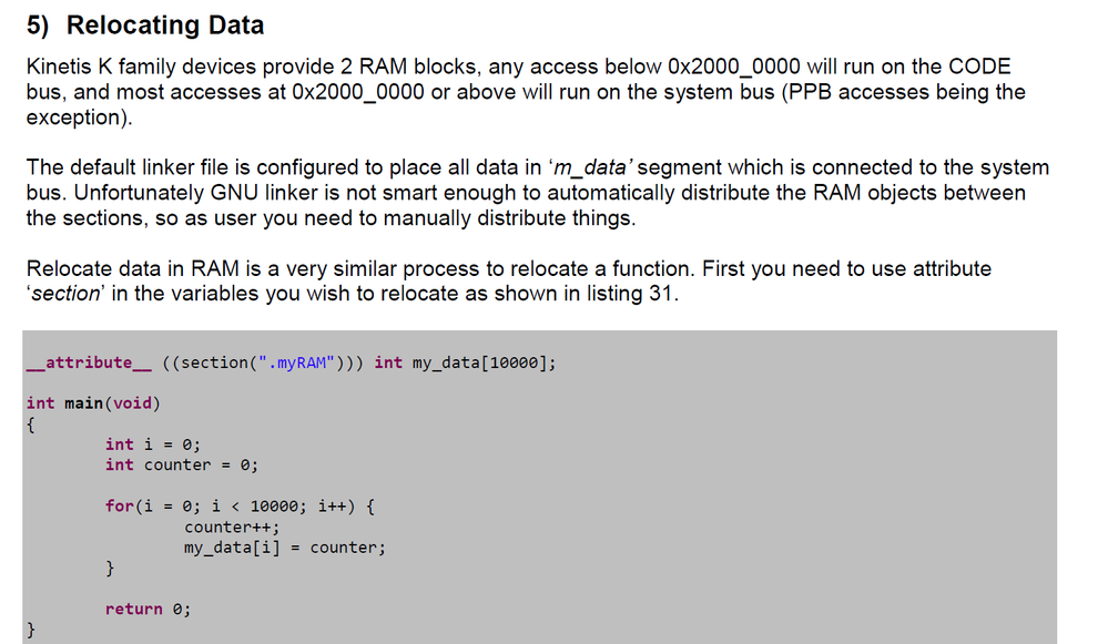

The linker file for K22 presents the RMA as two 64k blocks m_data and M_data_2.  Presumably this is to prevent the risk of locating across the RAM boundaries etc.  It locates the heap and stack into m_data_2 and bss into m_data.  But otherwise leaves m_data_2 as empty.
I need more RAM!  It seems odd to me not to have the unused space in m_data_2 used also for bss!
I tried to change the linker file and add a new section then locate my bigger arrays into this new section but I couldn't make it happen, instead the arrays just vanished from the map file!!!
Any advice on how to use all the available RAM?

Hello Ashley,
Does this DOC can help you ?
Relocating Code and Data Using the KDS GCC Linker File for Kinetis
especially this part :

2,515 Views
ashesman
Great, thanks that does help.  I had it all exactly like that but hadn't quite got the section definition right in the linker file...

ashesman
Sorry.  No problem.  It is all sorted now.  I was trying to say "I had it almost right but not quite..."  Thanks for your help.
